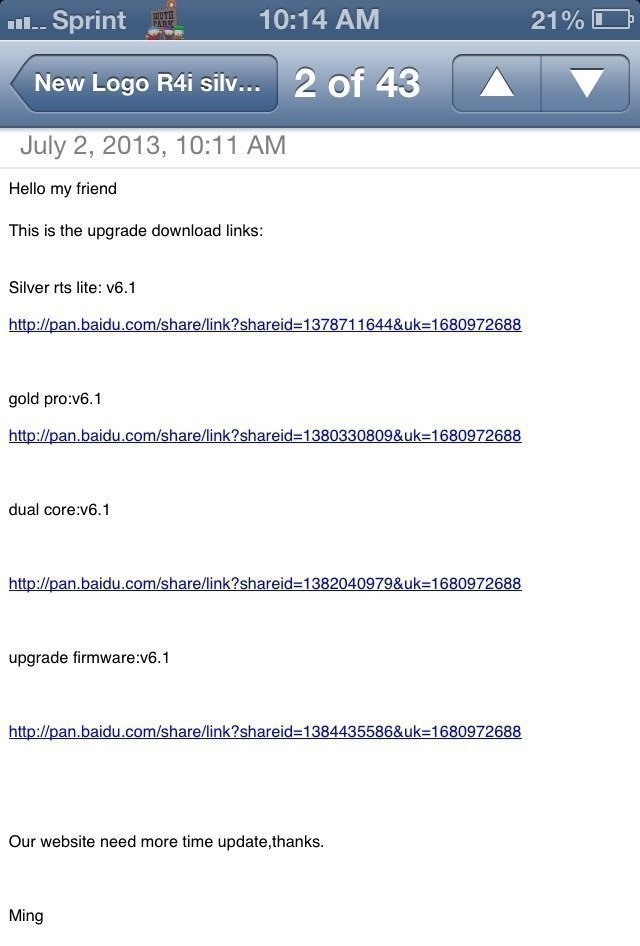

Hey well i received this message:
Hello my friend
This is the upgrade download links:
Silver rts lite: v6.1
http://pan.baidu.com/share/link?shareid=1378711644&uk=1680972688
gold pro:v6.1
http://pan.baidu.com/share/link?shareid=1380330809&uk=1680972688
dual core:v6.1
http://pan.baidu.com/share/link?shareid=1382040979&uk=1680972688
upgrade firmware:v6.1
http://pan.baidu.com/share/link?shareid=1384435586&uk=1680972688
Our website need more time update,thanks.

Hey, my webshop also released the 'official' firmware updates today, but very strange that there is nothing on r4isdhc.com.

And it still updates to 5.07 while Pong20302000 states that the last official firmware update is version 5.02.
Ming said they need more time to update r4isdhc.com lol thats prob it but if it works i dont see any problem other than if later on it has to be lowered to another version when updating
