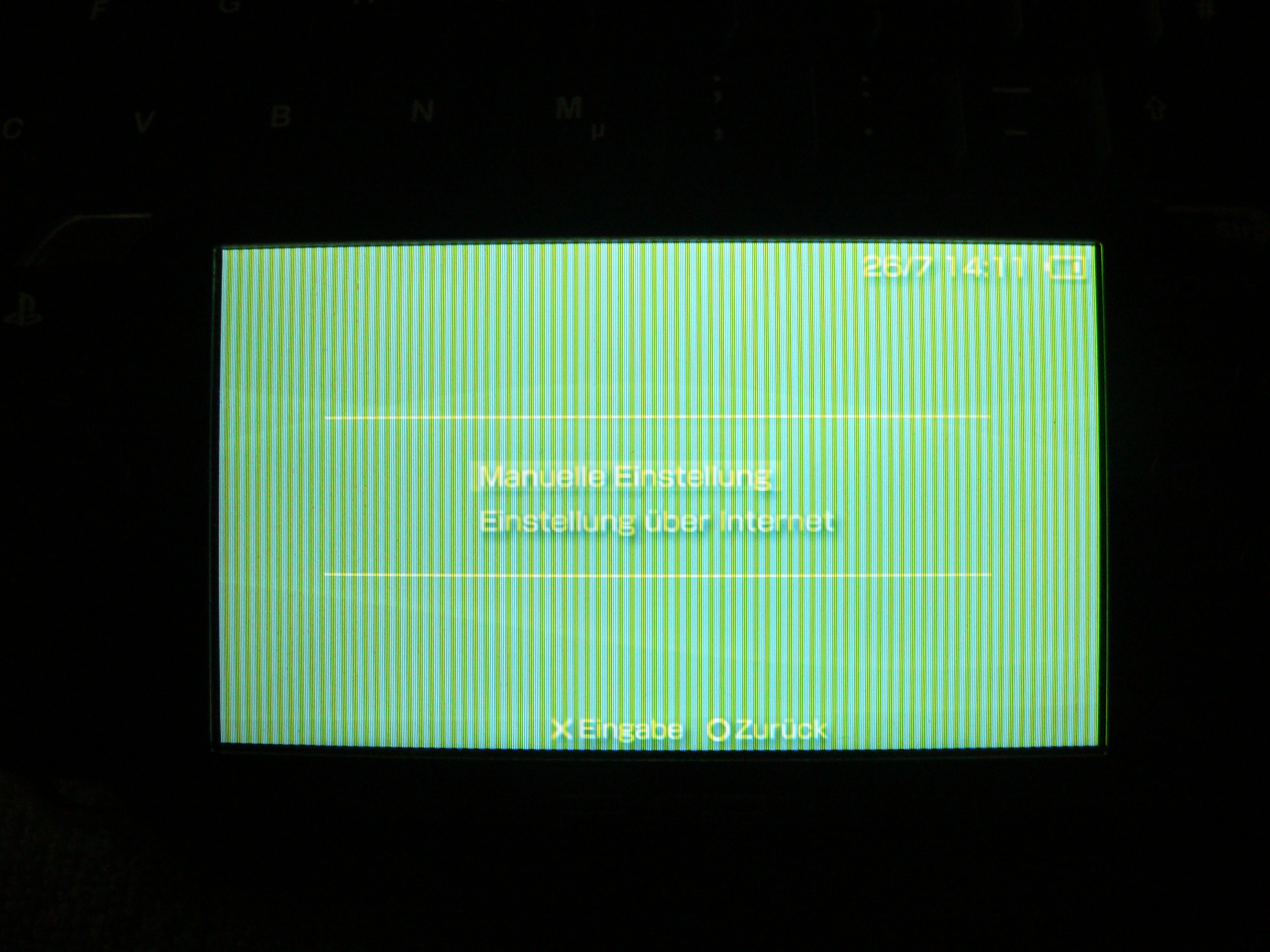

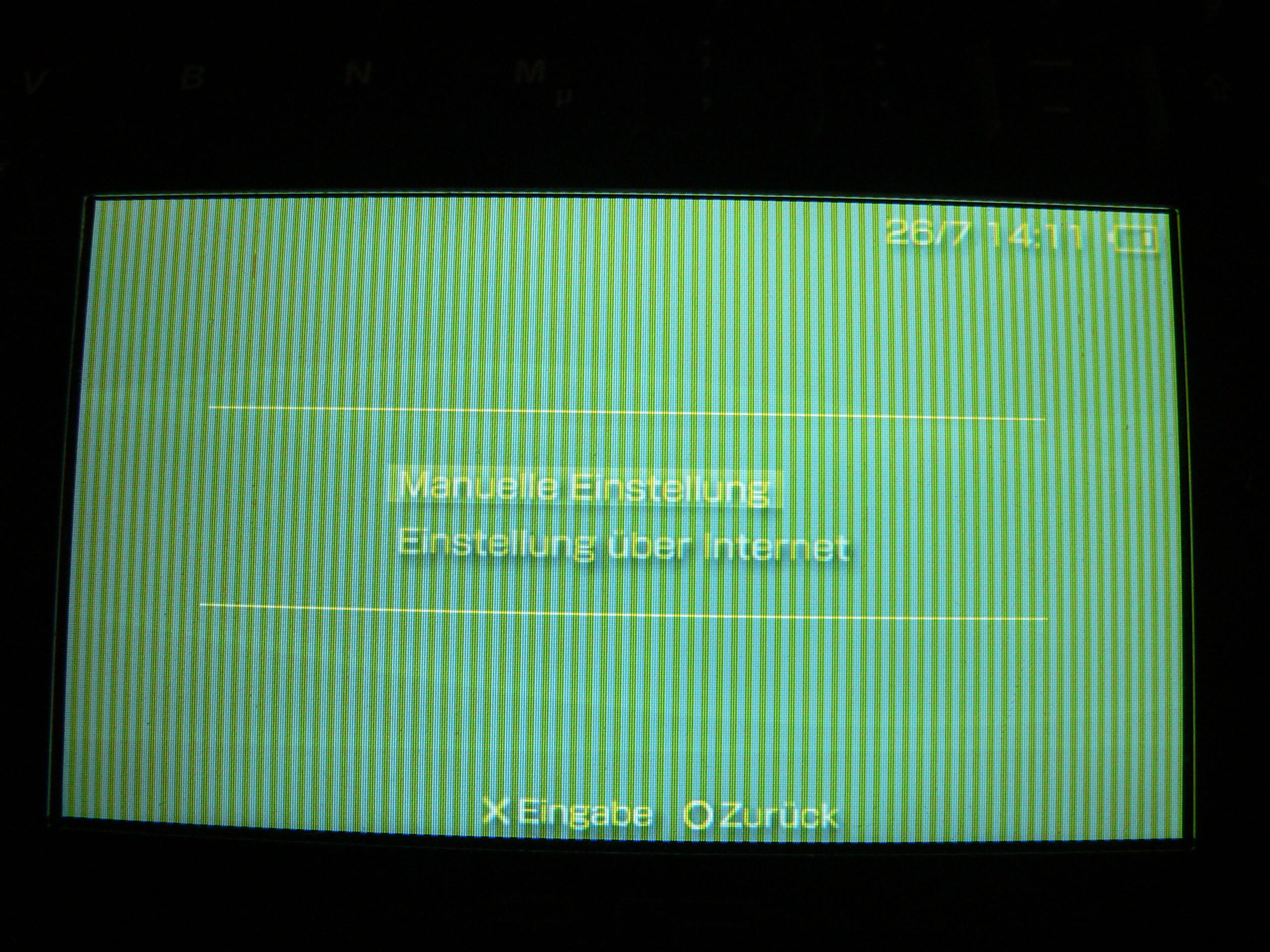

Hello.:)
Hello everybody, I have a PSP 2000 that was with vertical stripes and with a slightly faded image, I bought a new LCD, changed it and the problem continues...
As I have another PSP 2000 I decided to test the old screen and the new one I bought, both worked perfectly.
I connected the PSP to the TV with the component cable and the picture was perfect.
Does anyone have any idea what it might be?
Like this I think ?
I also asked for Advises:
https://gbatemp.net/threads/psp-2000-with-screen-issue.540283/
(The Pictures from the first Post are from BEFORE I have changed the Display.)
I have checked the Cable(s)/the Connector(s).....I have no Idea,I am very sorry.:(

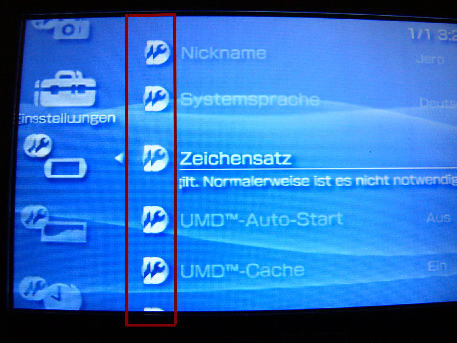

Now I am allowed to post images, here are some from my PSP:
It looks a lot like the problem your PSP has.
Yes,it seems really the same.Since you also changed the Display.
Please have a closer Look on the Issue BEFORE I changed the Display:
It seems some Parts of the Screen are "moved/displaced".....
Maybe the PSP was dropped by the Pre-Owner or something like that...:unsure:
The Lines comes afterwards the Display Change (and I mentioned it,it is a Display from Aliexpress,cheap China Ware).
So,maybe the Connector or maybe the Mainboard,I can not say it since I have no second 2000er PSP to test it.:)
Thank you.:)
