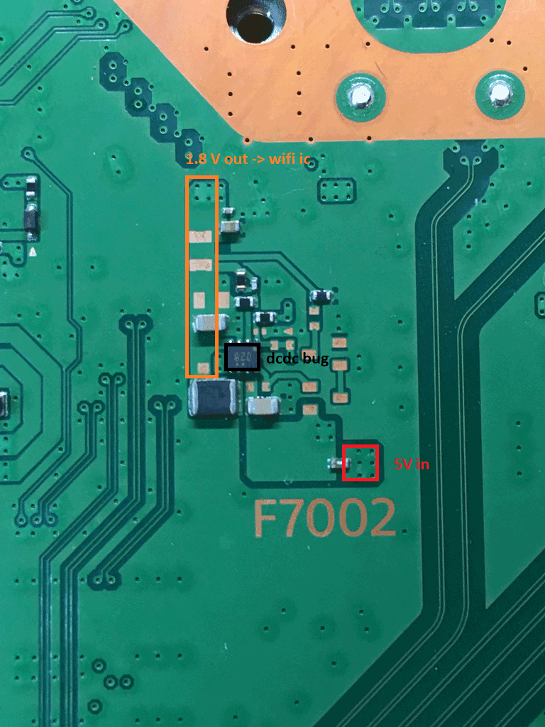

Yeah these wifi modules are garbage that Sony is using. Glad the post helped you fix your issue Dave. I now have a short at the F7002 inductor. Trying to figure out what feeds the 1.8v to that. I have all my rails all the way through. 12v, 5v 3.3v, 2.0, even have 1.8 on one of the front facing resistors on backside of board where southbridge is located. Short is only on this side indicated of the inductor. The other side is where the take in of 5v is.
The 1.8V are generate at the tiny dc dc bug next to your missing inductor and is feeding the WiFi ic.

Any ideas of what supplies the 1.8v rail to the F7002 inductor on an EDM-020 board? I have 1.8v on the front facing resistor on bottom side of the Southbridge.
Maybe I got your question wrong. But the dcdc bug converter is generating the 1.8V and is feeding your inductor/coil.
