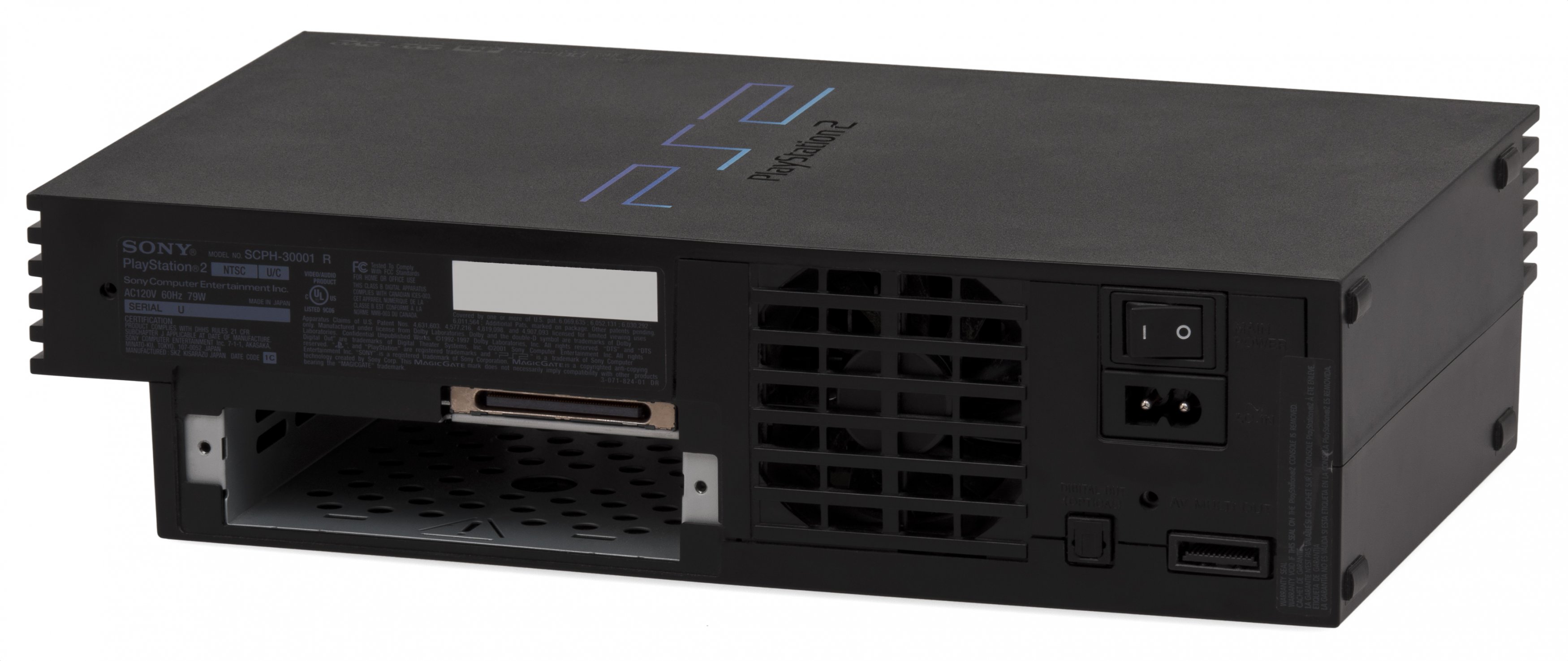

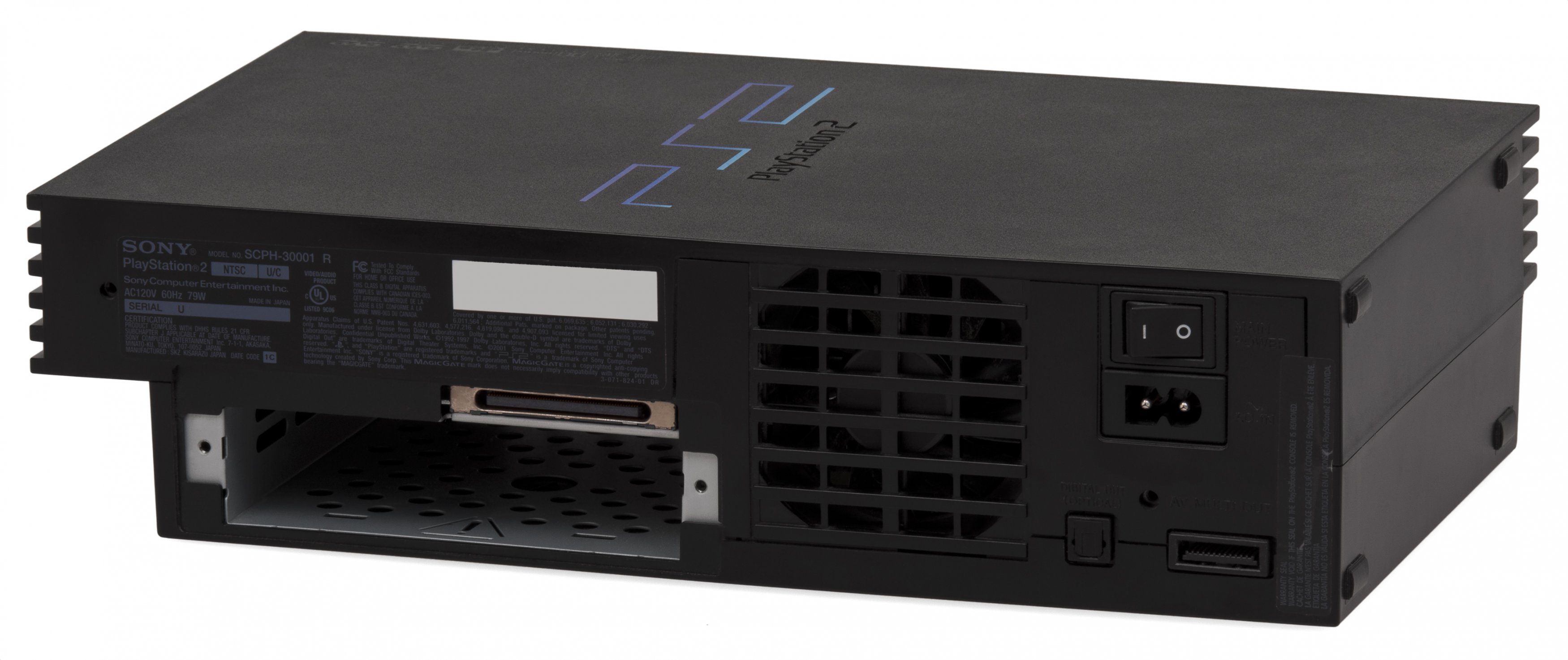

First: a PlayStation 2 with HDD Bay:

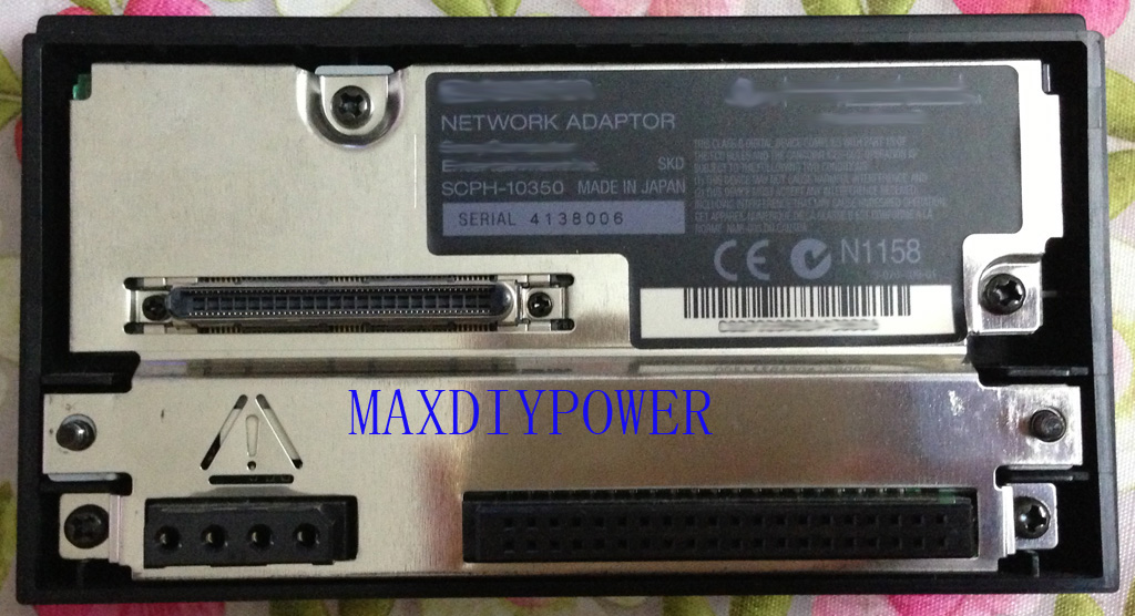

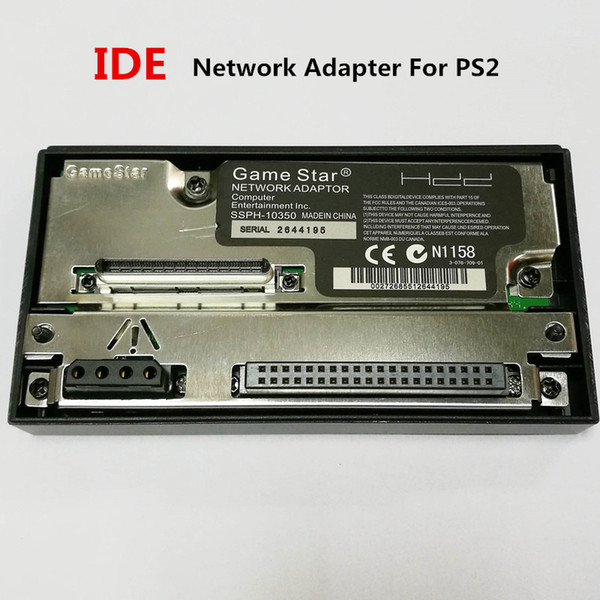

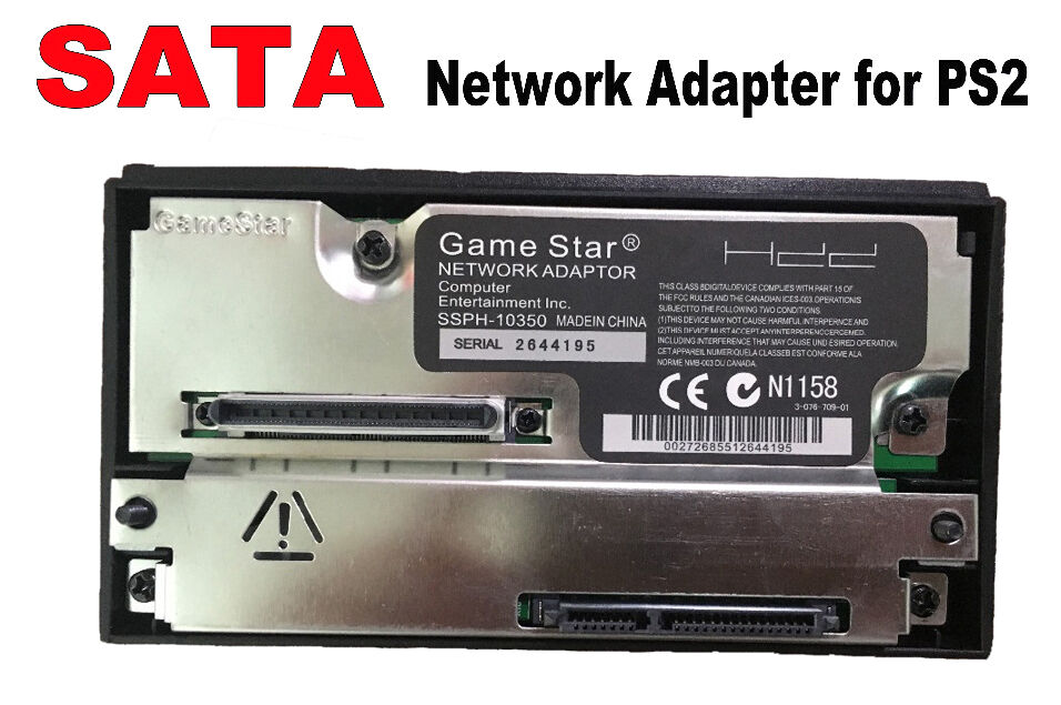

Second: the HDD/Network Adapter:
For IDE HDDs original Sony:
For IDE HDDs 3rd Party:
or for SATA HDDs only 3rd Party:
