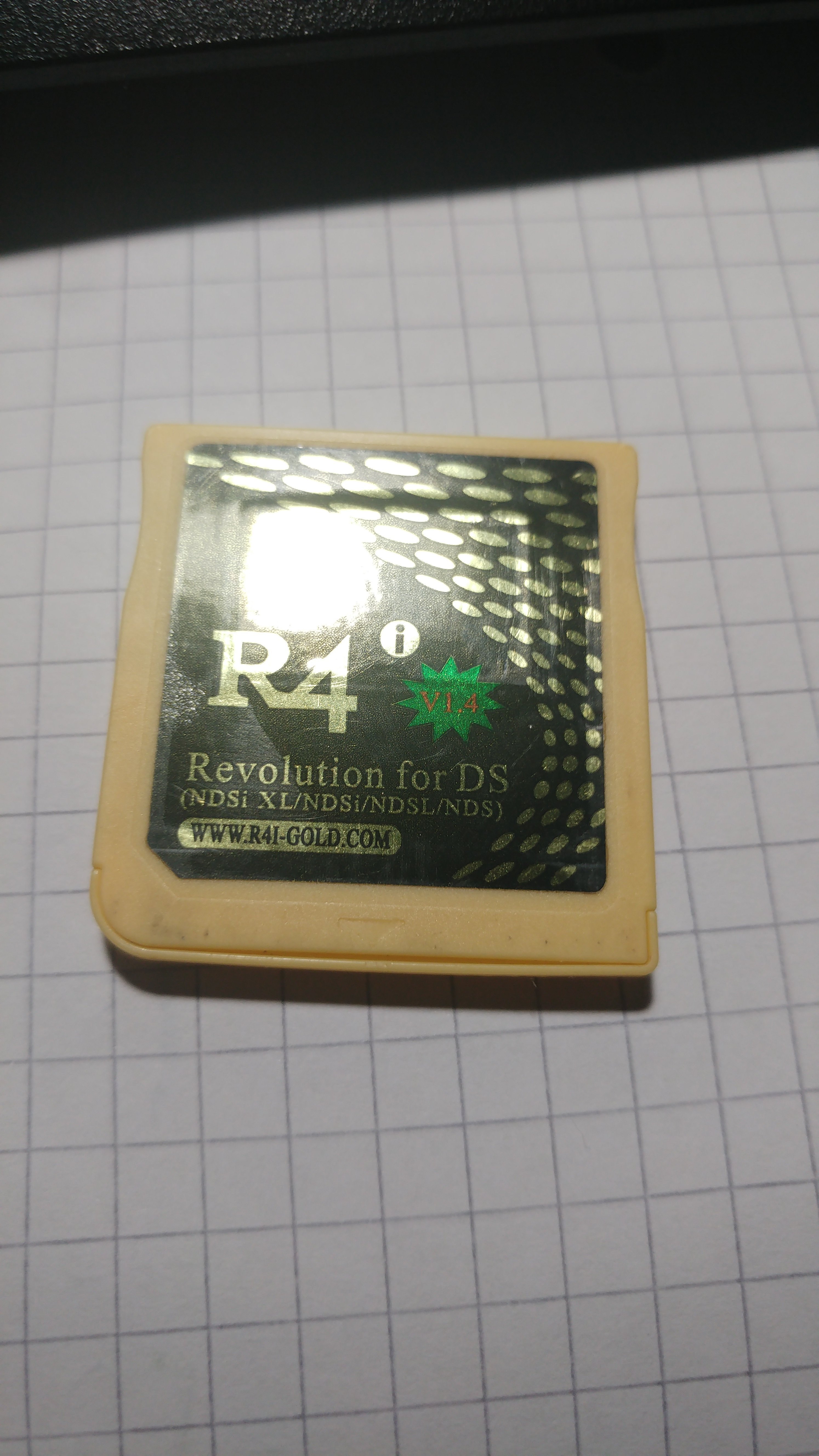

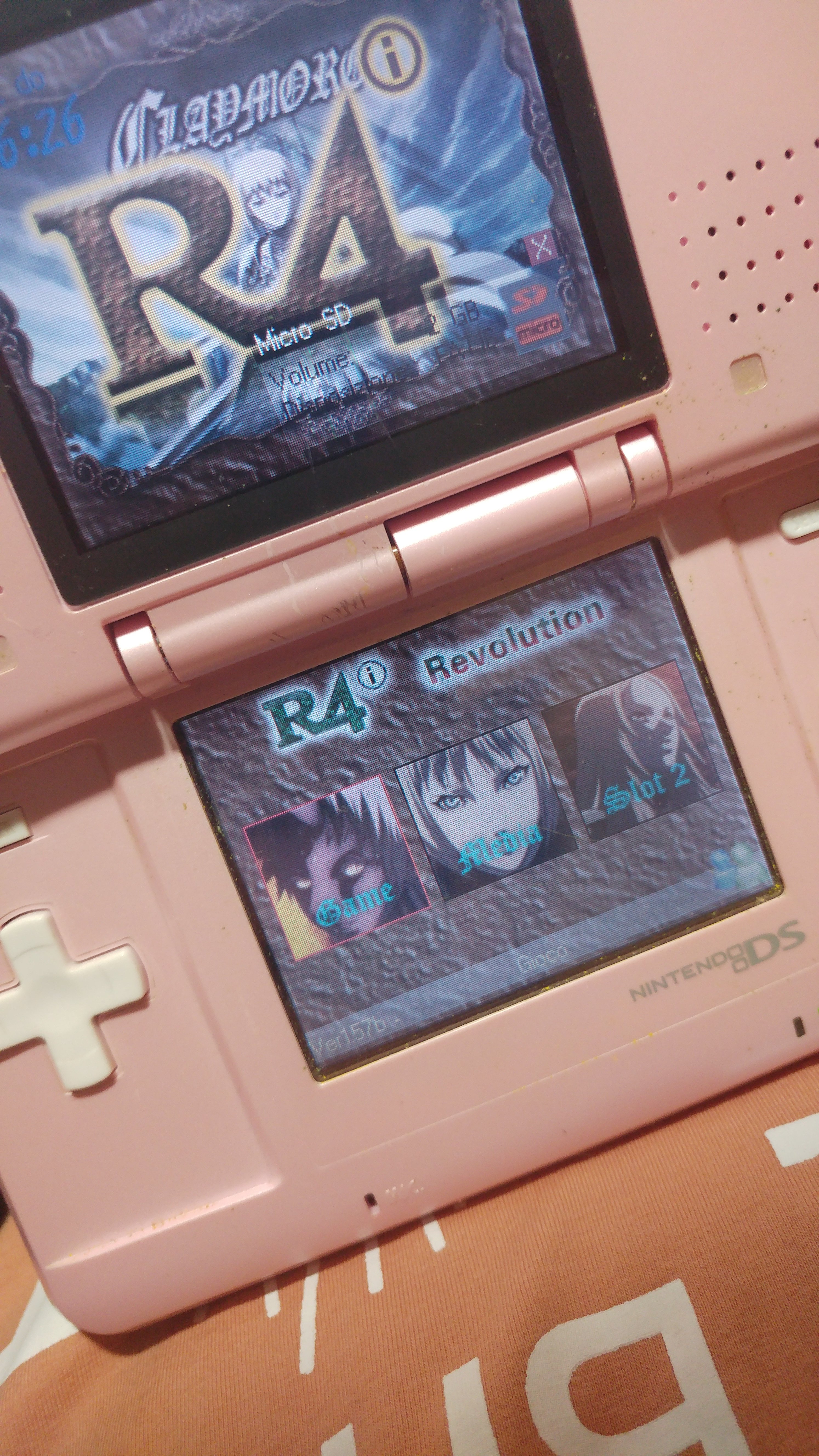

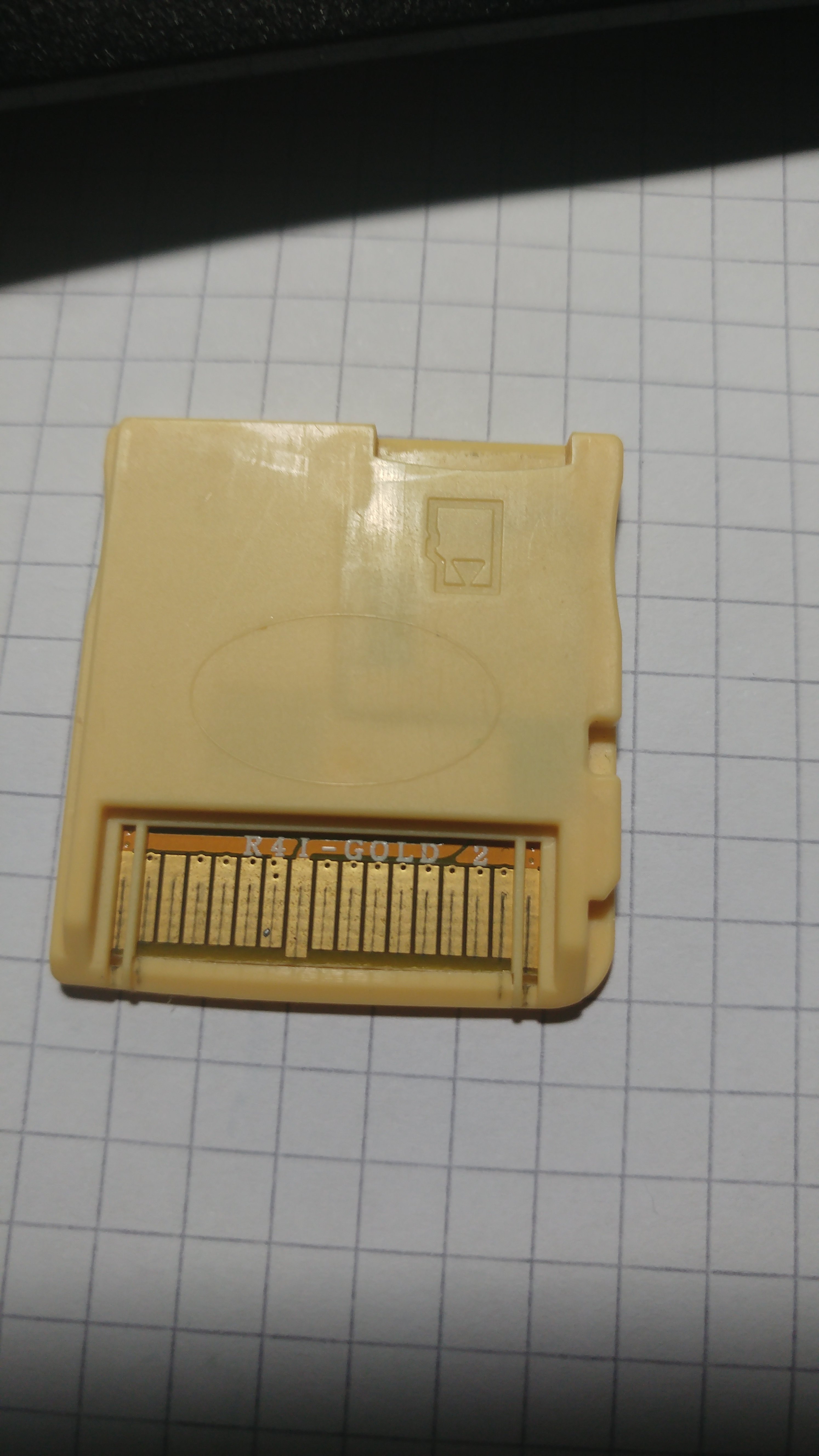

First of all sorry if i make any error, english is not my main language.
So i got an old r4i gold v 1.4
20180906_204514.jpg 20180906_204520.jpg,
my sister updated the Nintendo DSi to 1.4.4E and now it doesnt work anymore.

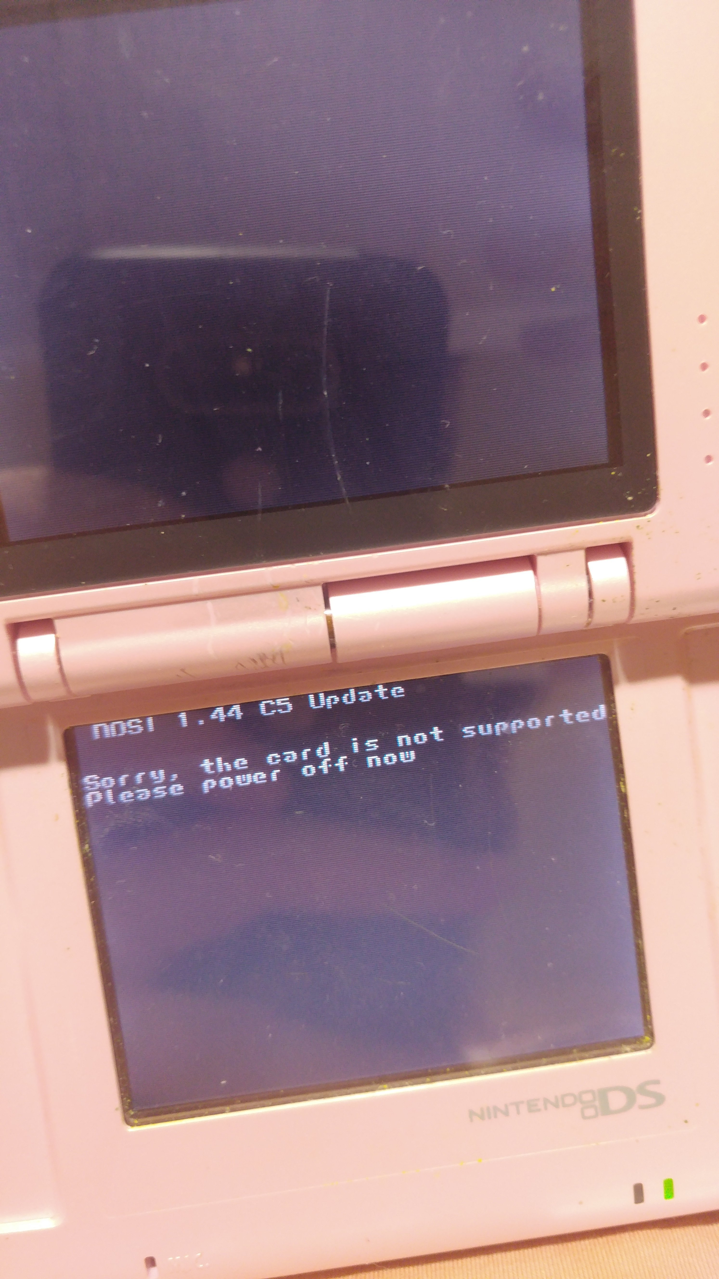

I tried to update the firmware with an old Nintendo DS (the fat one) and it gives me this error:
It is the card not supported at all or there are ways to actually make it work on the dsi?

Nothing else you can do, that flashcart is a clone. Since the never released an update for later firmware versions of the DSi, you are stuck with it. You can always downgrade your DSi back to 1.4 though via ugopwn.
