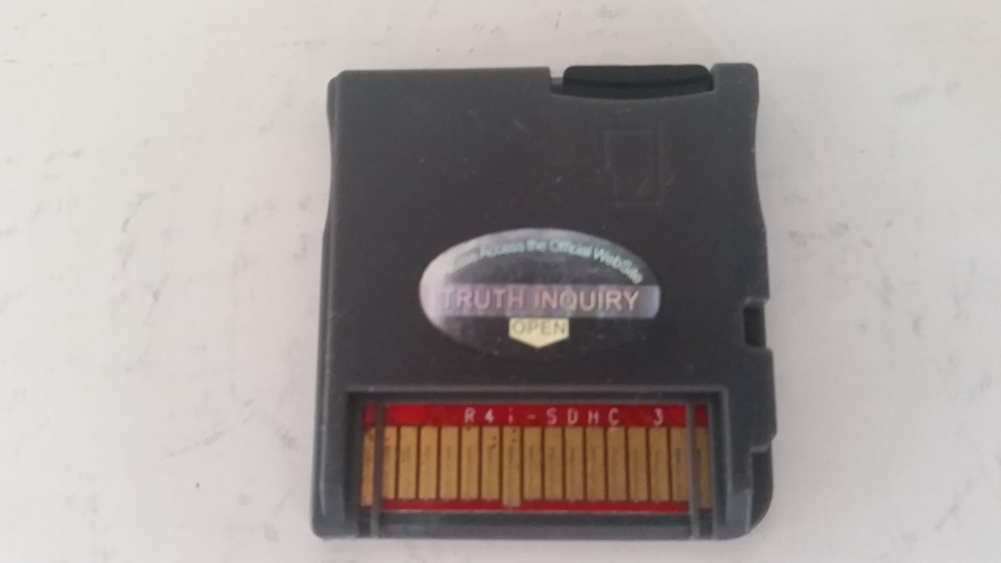

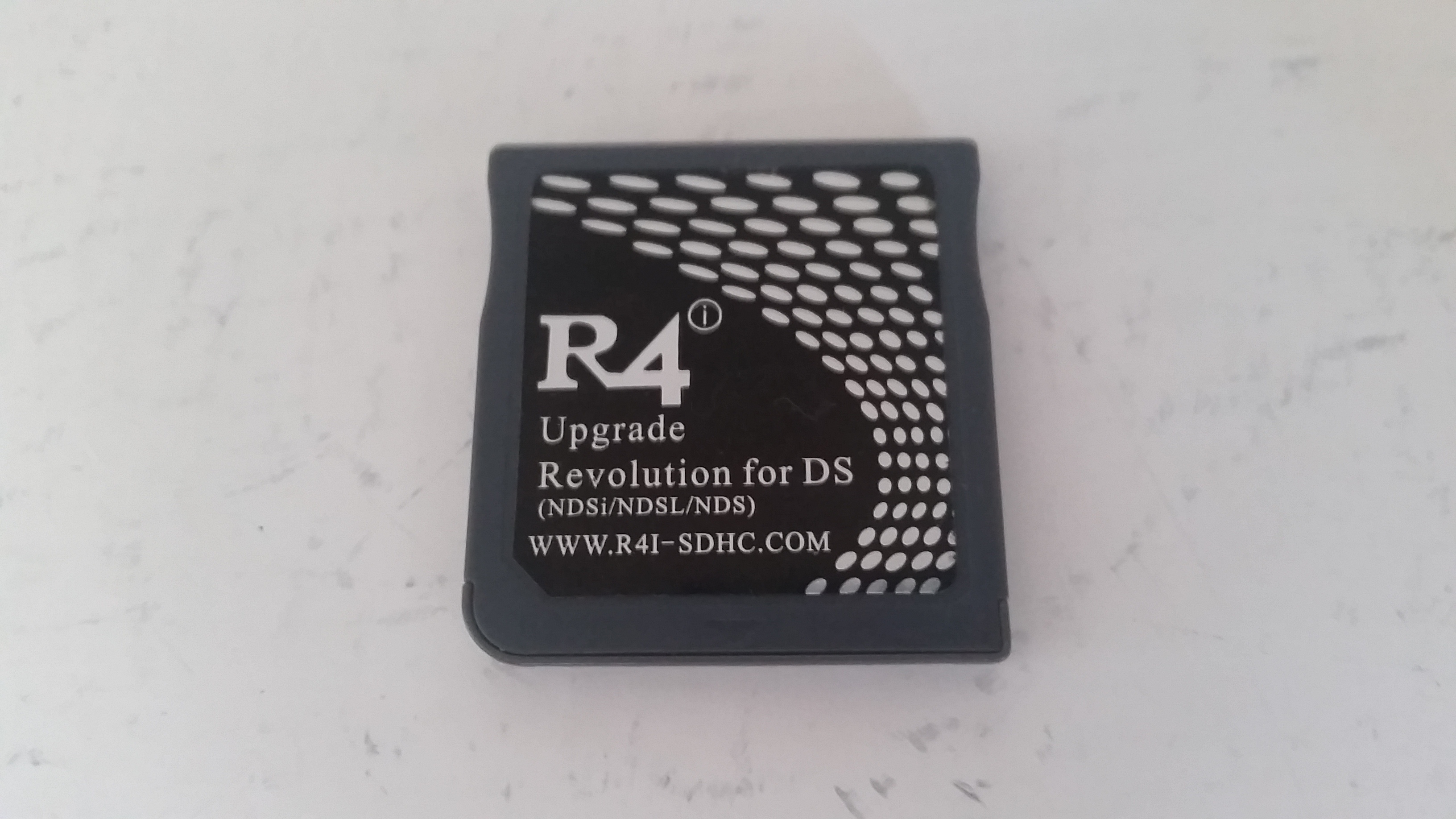

I did find this R4 I forgot I had that I never really used, though I don't know if it's compatible with the ntr method. (and i still need to get a magnet (what kind of magnet?)).
