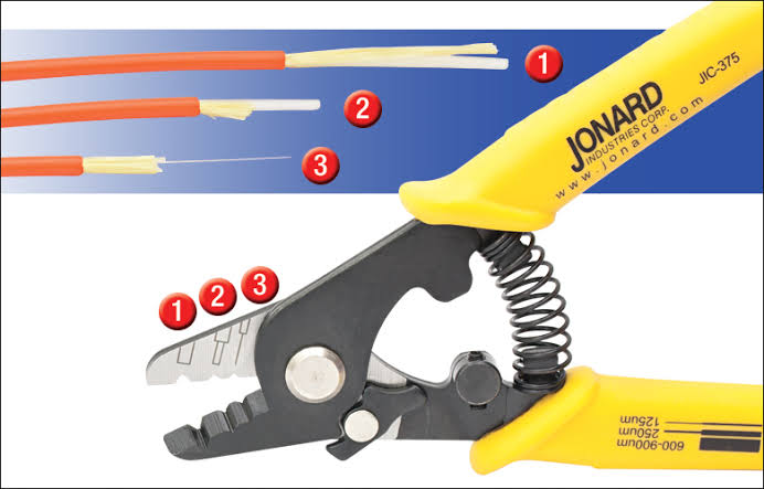

Nice work. Those look like 38-36awg single core wires right? What did you use as wire stripper? Can't seem to find one for that wire gauge.
I have a tool for stripping fiber optics, like this one in the image. It works exactly for this type of service. It gets very easy.
Search for the name: "Three Hole Fiber Stripping Tool"

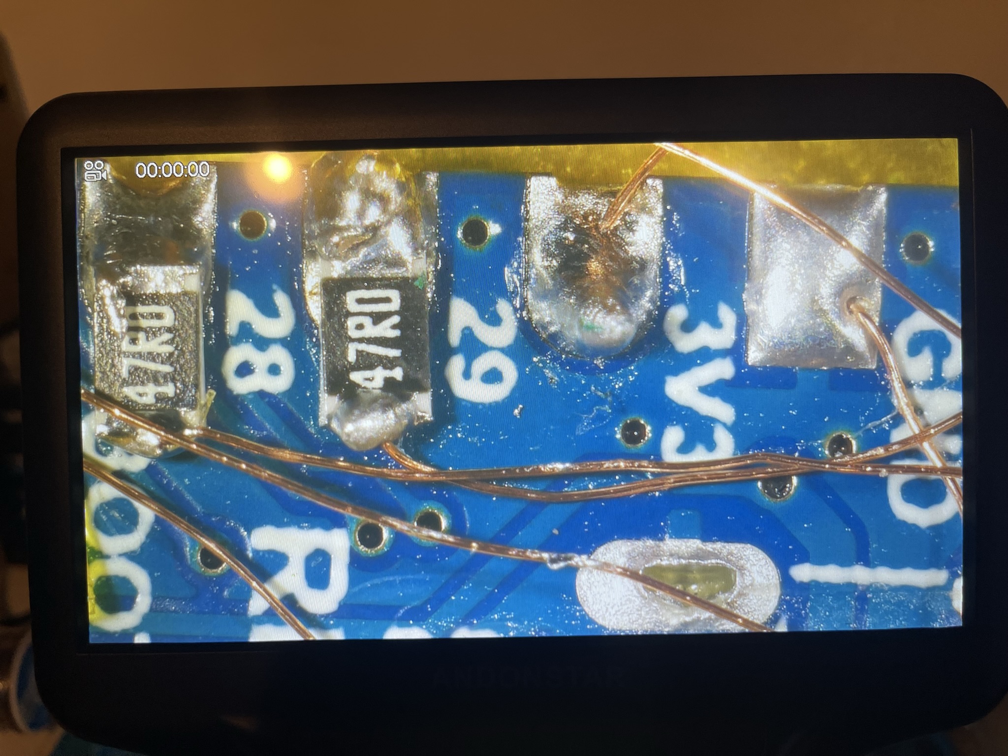

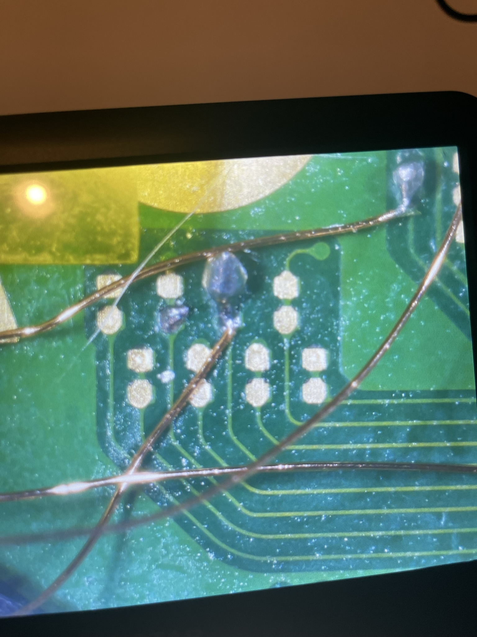

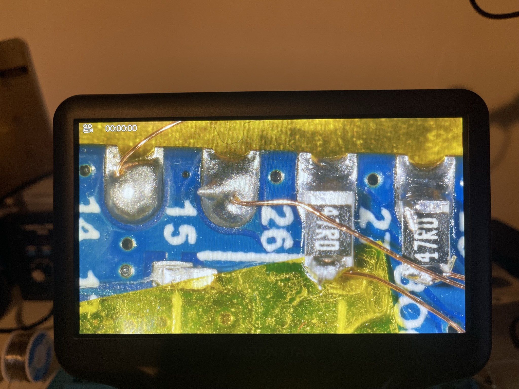

uhhh, i got a erista model, but the light doesnt even seem to turn on, what could it be? it just goes to OFW
EDIT: Fixed what you said, and weirdly enough, it works it boots up to no sd. But theres still no light. What happened? Just checked that the rgb jumper cable was still on there and it sure was, just to be 100% sure i just bridged them completely now so its 100% locked in but theres still no light, did i break it? it was still working when i installed FW

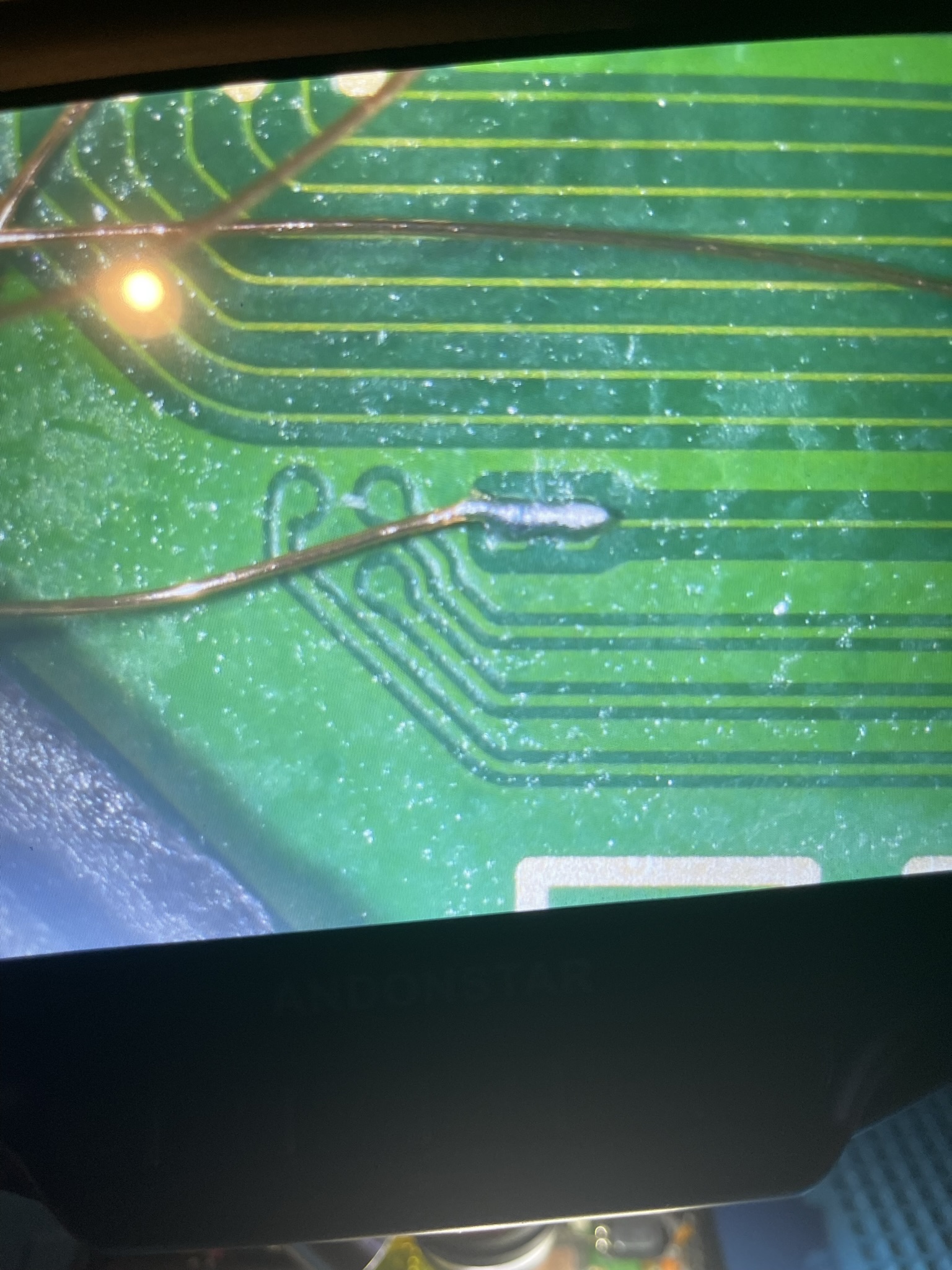

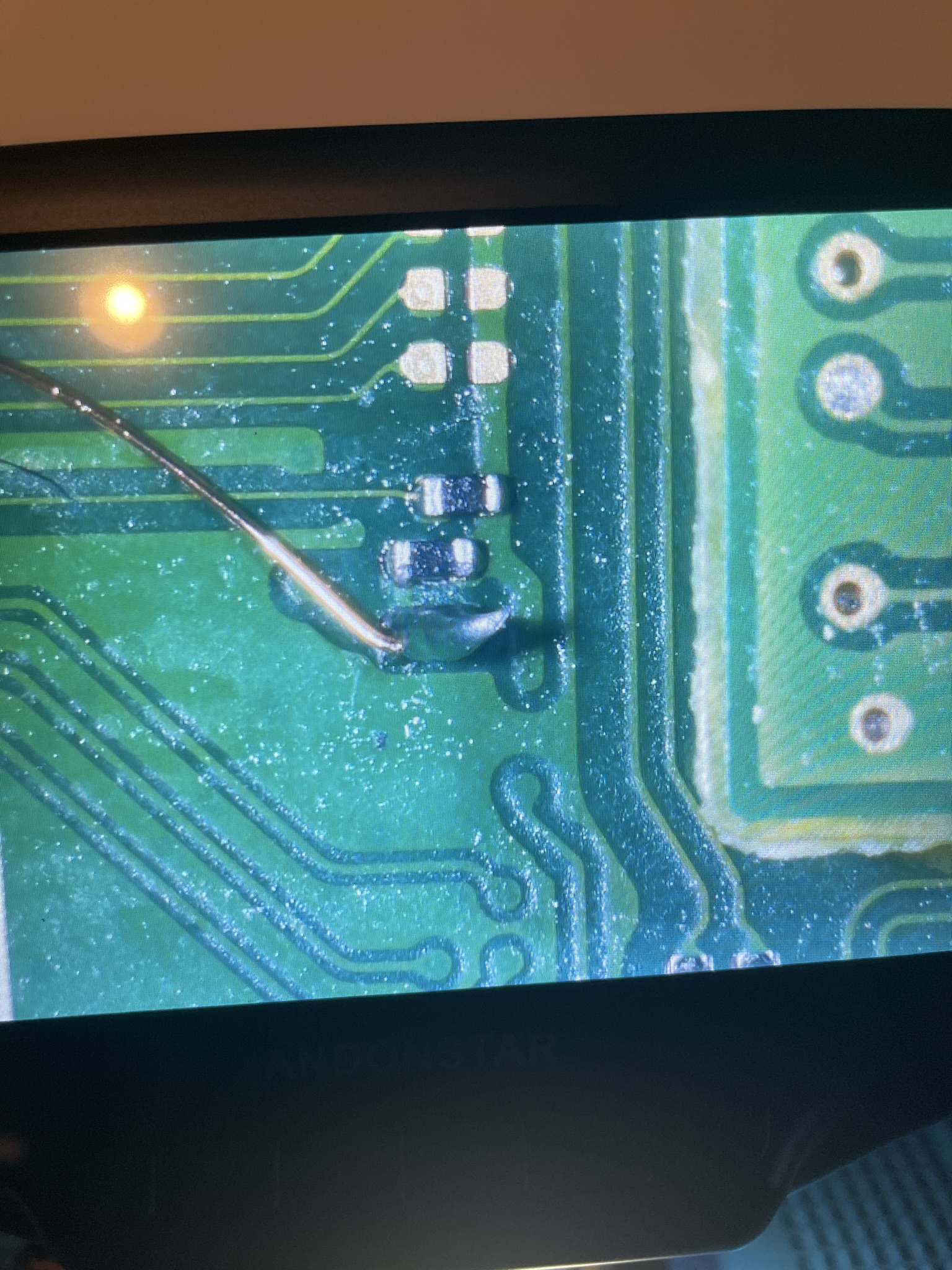

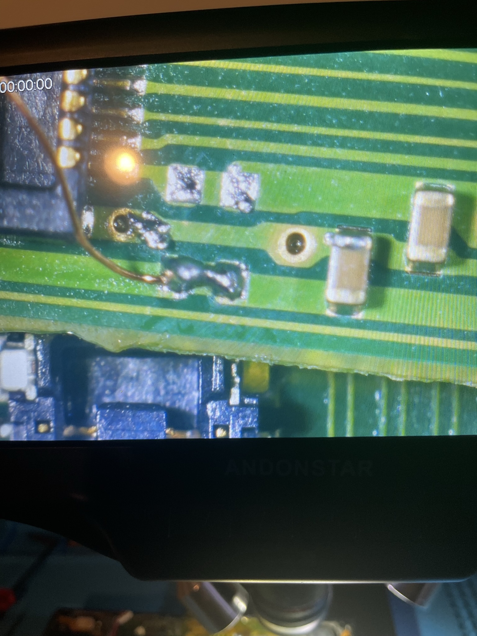

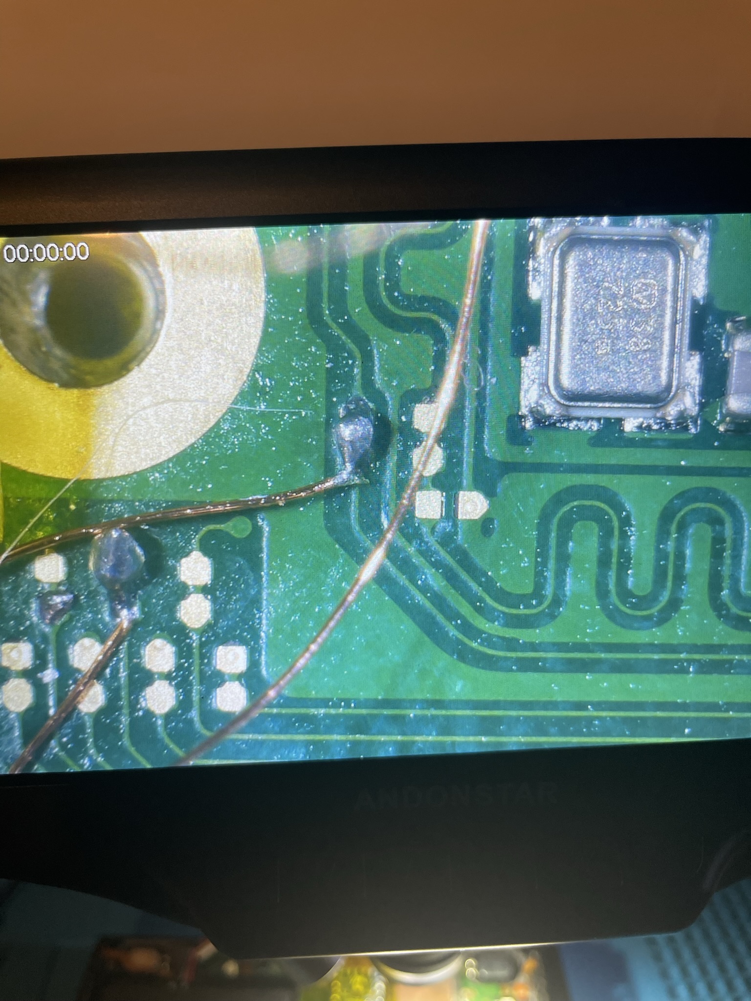

This is a V1 erista. I dont completely understand why there is no light turning on, or why does the nintnedo logo show up when i try to boot it up. Also i chose that 3.3v cus its easier for me to do but maybe its different on the erista model? idk Something isnt right, please help. Thanks!
Wrong dat0 connection

wow im stupid lmao but shouldnt the chip atleast turn on?
Well god knows what that dat0 line is solderd to so maybe it's preventing the pico from starting.
Also you should use thicker wire for 3v3 and GND.
Also make sure that you don't have a "cold joints" when using that enameld wire.
The solder points should look more like the green photo attached. The ones you soldered on the pcb seem ok but you should check those on pico once again.

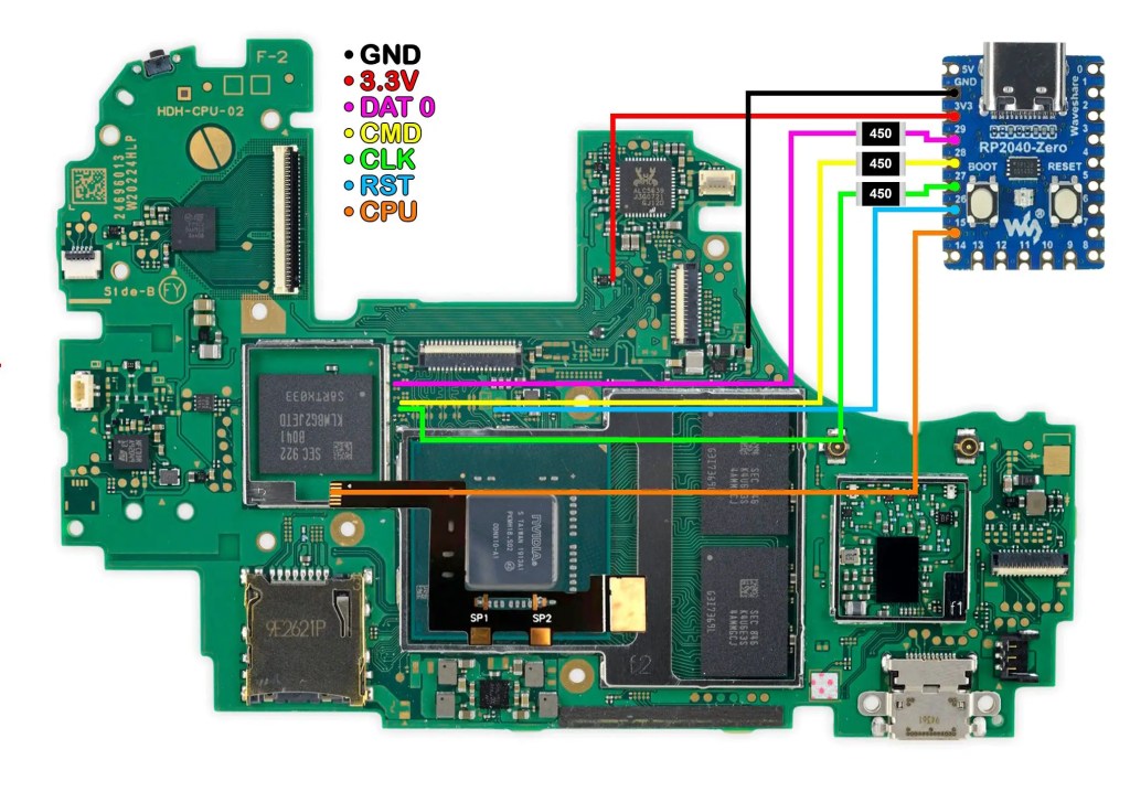

Did you intentionally, or unintentionally release an already outdated video guide in regards to the picofly firmware? 2.5 + unlock has not been recommended for several weeks at this point. Current firmware should be 2.67 and NO UNLOCK BIN.
This pinout of the Lite has been around for a long time. So that's not true with the 45 ohms?
If it has been around a long time, and newer, more accurate information has been provided, does that not mean the graphic is outdated and technically untrue?
