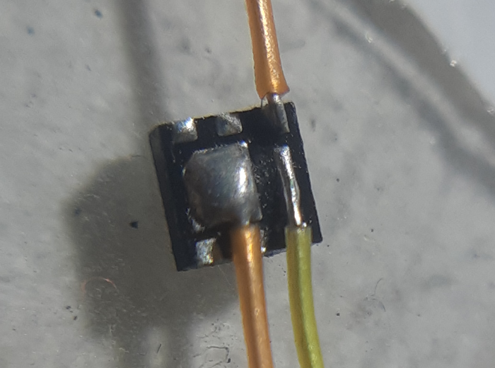

Unlock another v1 patched. Just bring me this version. Here I go, again...
