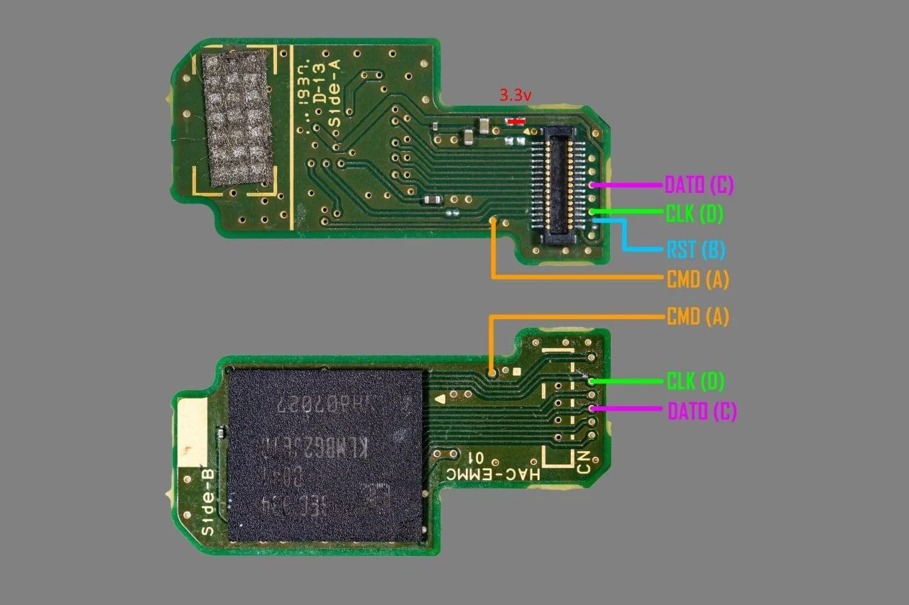

I took 3V from EMMC this one:
https://gbatemp.net/attachments/1683439705035-png.369534/

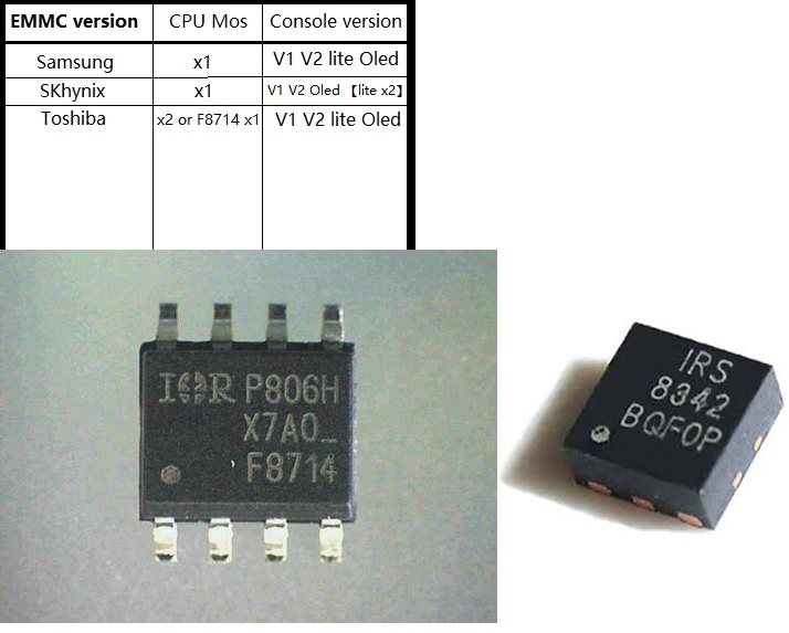

Hi, mosfet issues? try replacing the mosfet(s). If you're using a ribbon, try to replace that, since some of them are of poor quality.
