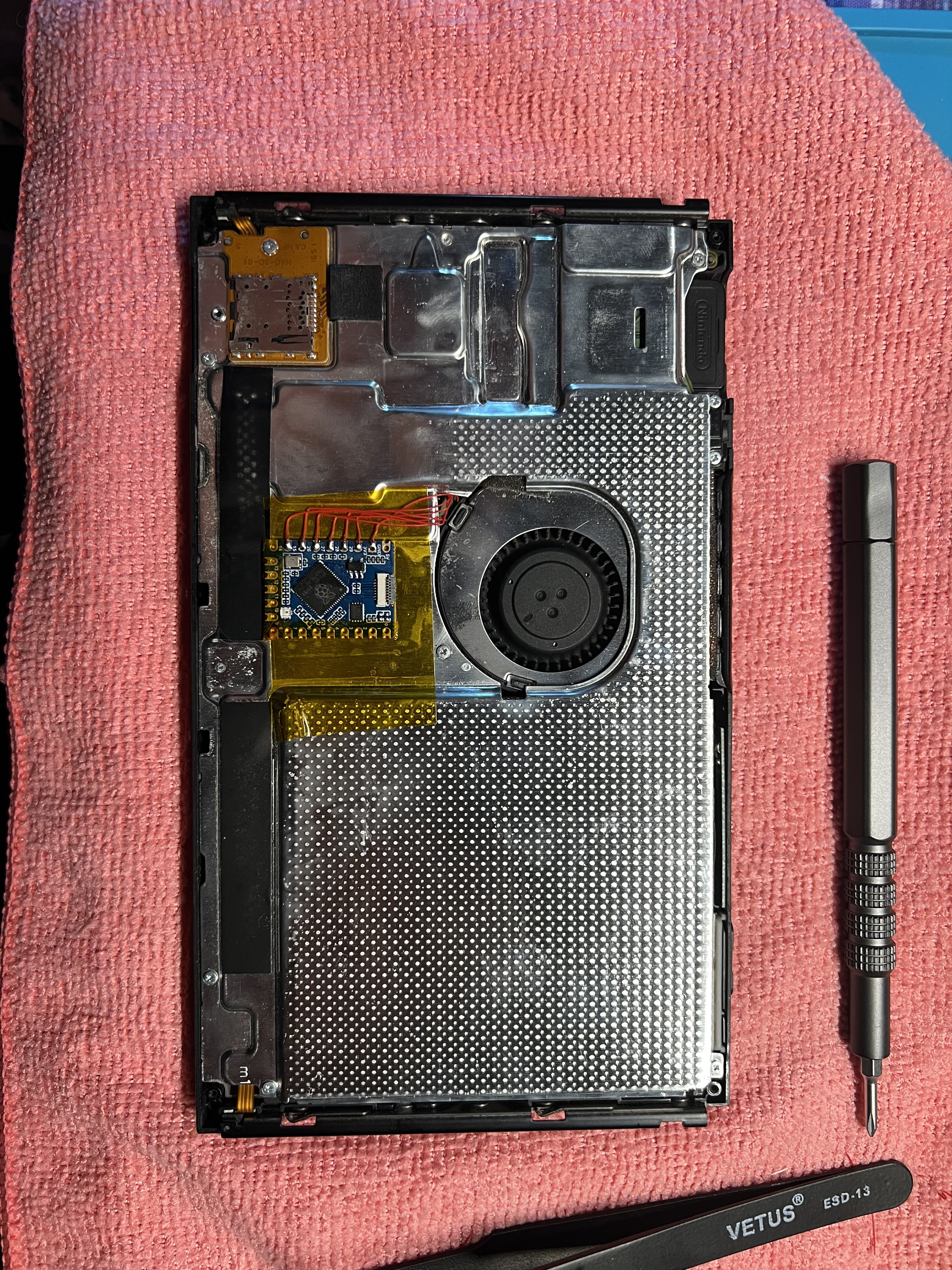

v2 mod chip installed. Im happy with the result. 😃

I've tried the kamikaze, so far it was good. I can't say perfect since I almost cut the cmd line, however it works great. No more failure. 😄
Wow, congrats :grog:
Which tool did you use? How long did take? Did you make any pictures of the process?
I'm happy it worked out, cheers
I used a mini grinding tool MaAnt D1 with a fine tip. Maybe the grinding process took me about 30mins. 😆 i wanted it to be as perfect as possible since it is my first time and my own.
I did a practice on a throw away pcb until I got the hang of operating the grinder on microscope and did the job. Unfortunately due to excitement i forgot to take photo. 😅

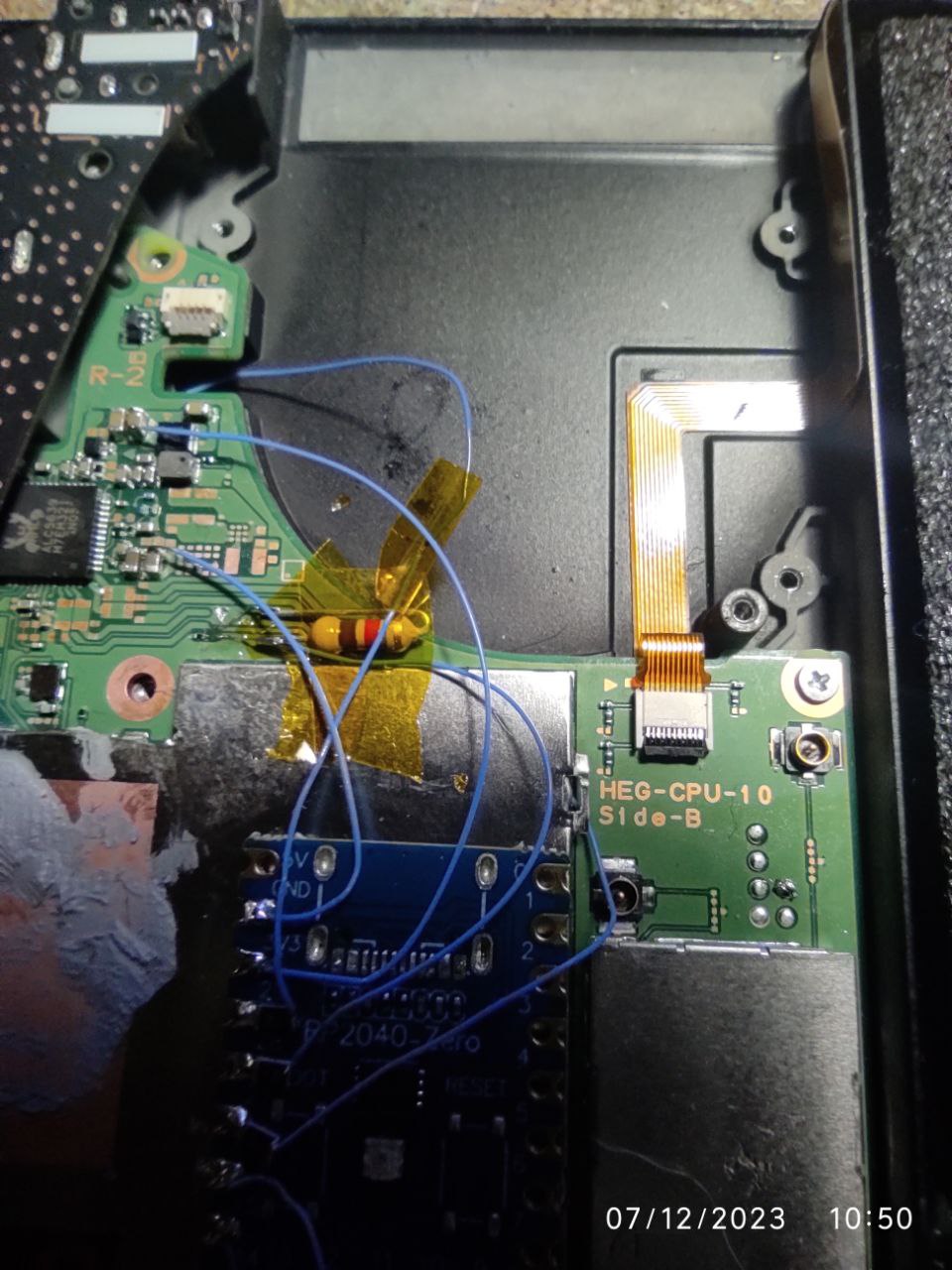

Hello, I have a problem with this chip, it has the latest firmware available, it turns on a couple of times and then doesn't want to turn on again until I disconnect the battery from the console for a while. I have another spare chip but I would like to know if it is possible to save this chip
Maybe you're using too thin wires, special for 3.3V and GND points. And must isolate chip from the metal frames, be careful with that.
I'm going to try replacing the cable with a thicker one, I already put double-sided tape under it, it's not making contact with the metal
I already replaced it with a cable twice as thick, I was using 0.10mm now I'm using 0.20mm and it's the same problem, is there anything else I can try?
What point do you use for 3.3 and the GND?
Did you try the other rp2040 just to make sure it's the chip?
Couple of suggestions:
-The enamel wire can be tricky, might get scratched and create a short or the insulation might not burn while soldering resulting in a cold joint (it appears to be soldered but it's actually just stuck on solder and not making contact)
-The resistors you are using have a very small contact area so you should check the soldering there aswell.
-If you did not remove the LDO (the little black 5-legged thingy on thr back) it might couse a problem. You should remove it since it's not needed anymore.
-I also had one problem with the crystal (the little shiny thing on the back) but my rp2040 was not working at all so this is unlikely in your scenario.

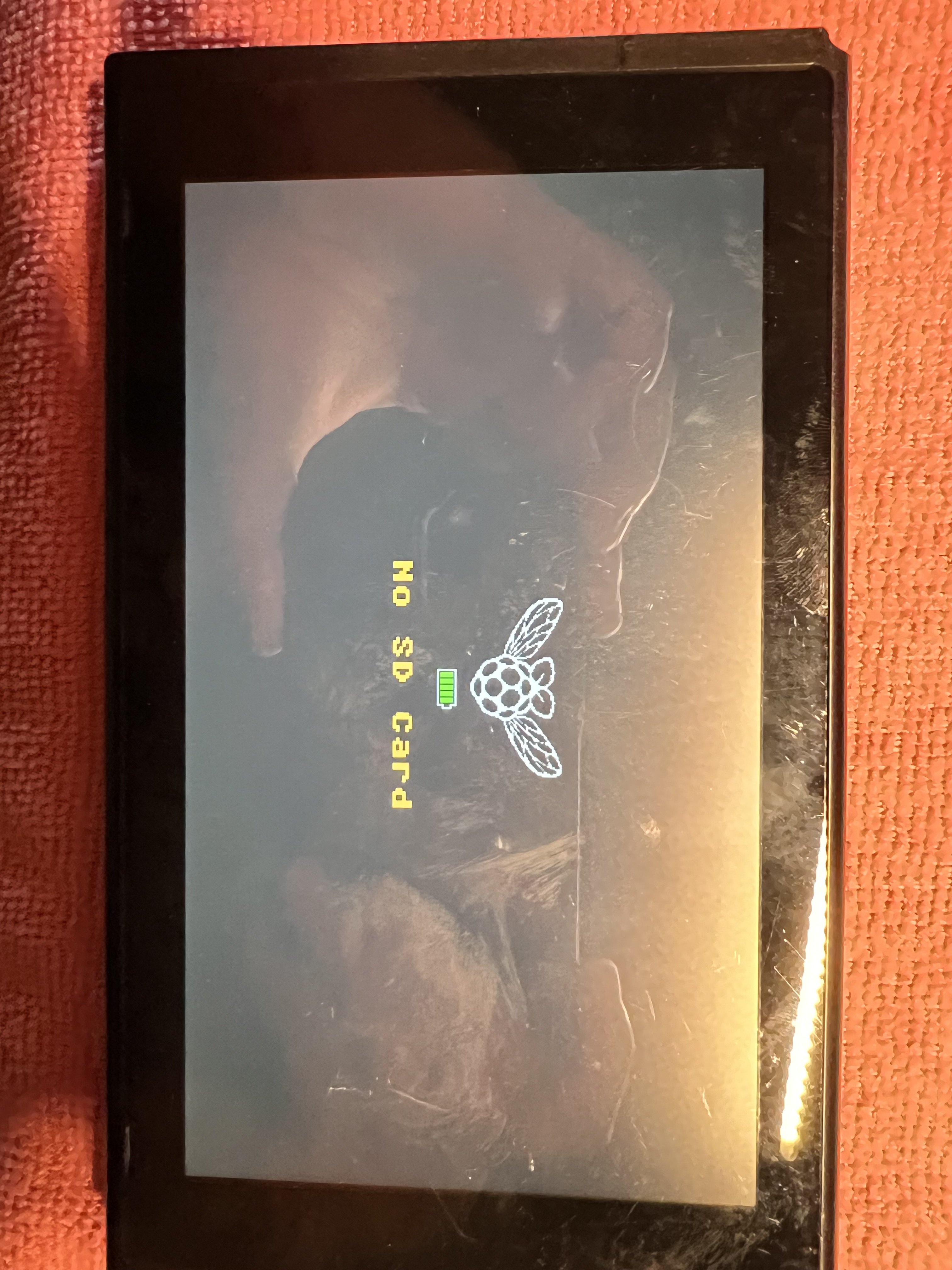

same here, I got tiny from waveshare official site and they came with RGB test code out of box. Nuke them and put v2.75 fw on it but no success flash after that. Howevevr, I do have ** code when replugin to PC without holding boot button after fw flashed. So they are good to bang on.
Just make sure you have ** code and you should be good
If in waveshare tiny with 2.75 installed, when you plug usb again gives you one long blue and 3 ** yellow (6 total), is it a good sign? Shall I move on and remove usb port and buttons from the chip?
where is the port or button from tiny?
Yes, ** error code 3 times in total. AFAIK, the picofly fw check rst first so you got error code/LED **
