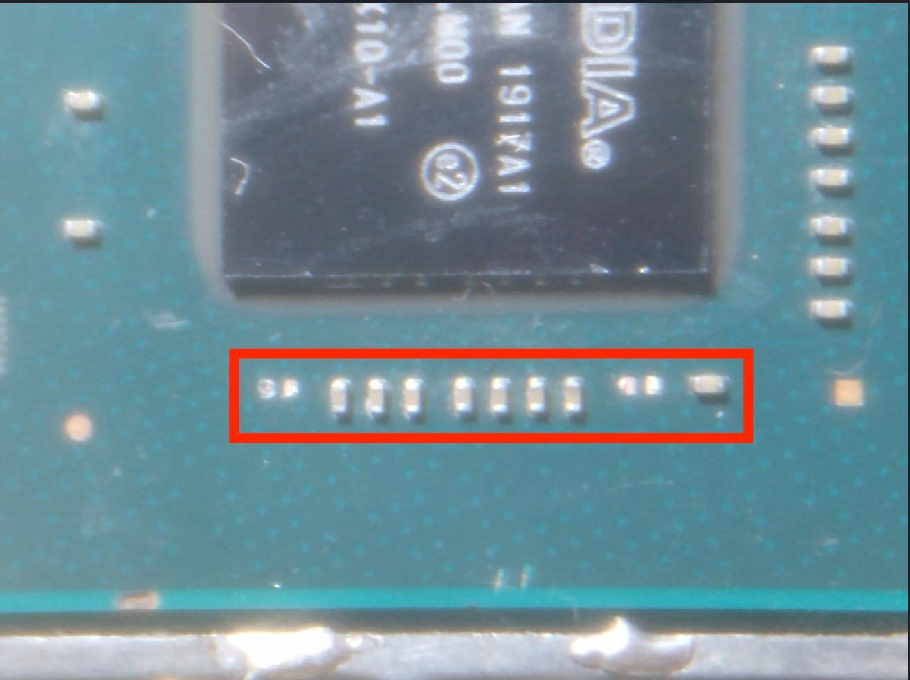

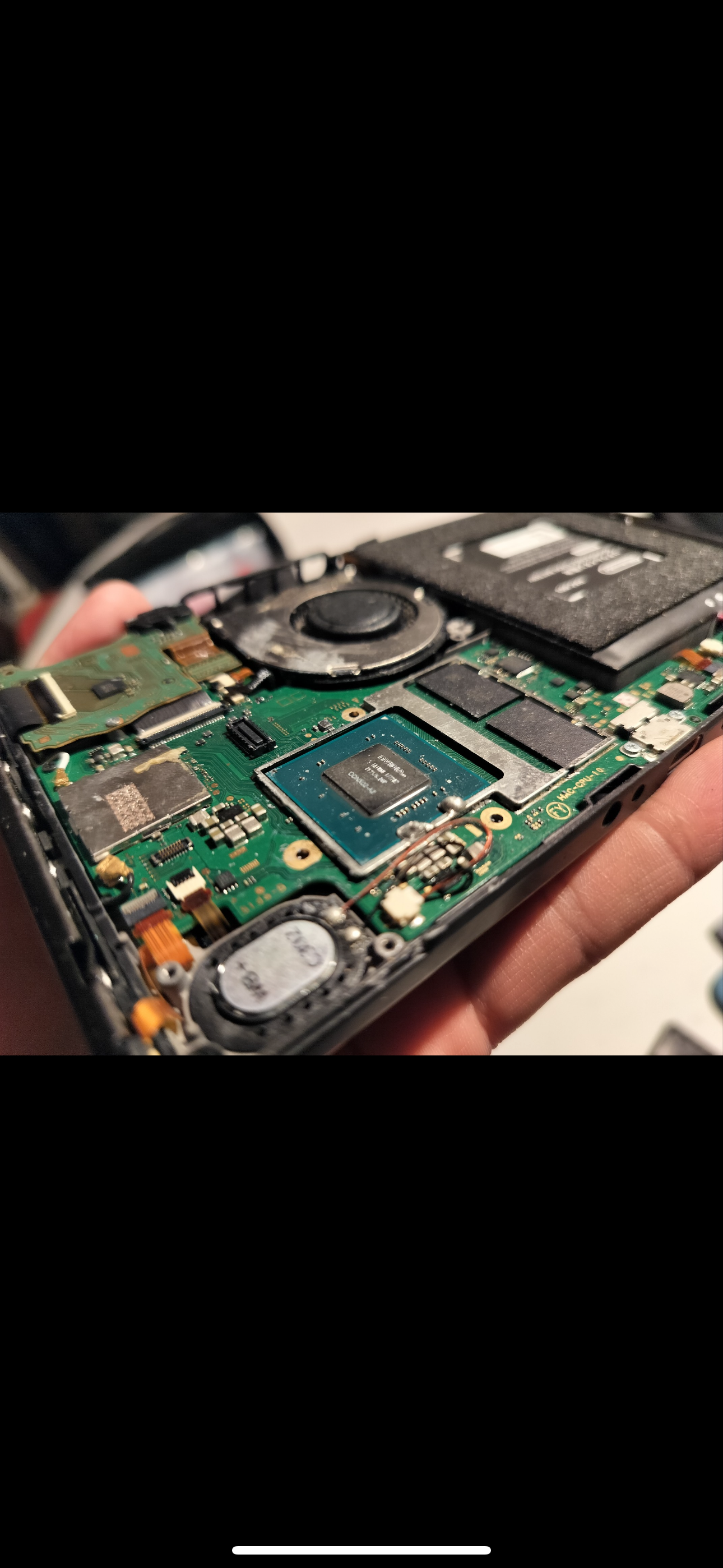

Will a switch boot with a missing cap on the cpu?

i had a switch lite with two missing caps and boots ok.
didn't try to play for a long time
I’ve always replaced then before turning it on so I wasn’t sure. Guy is saying it won’t turn on and this is the only thing he could thing of. It’s a V1.

How can you tell it’s unpatched? Guy was trying to install a mod chip and accidentally took off the cap.

You are correct but he’s saying it was never modded.
