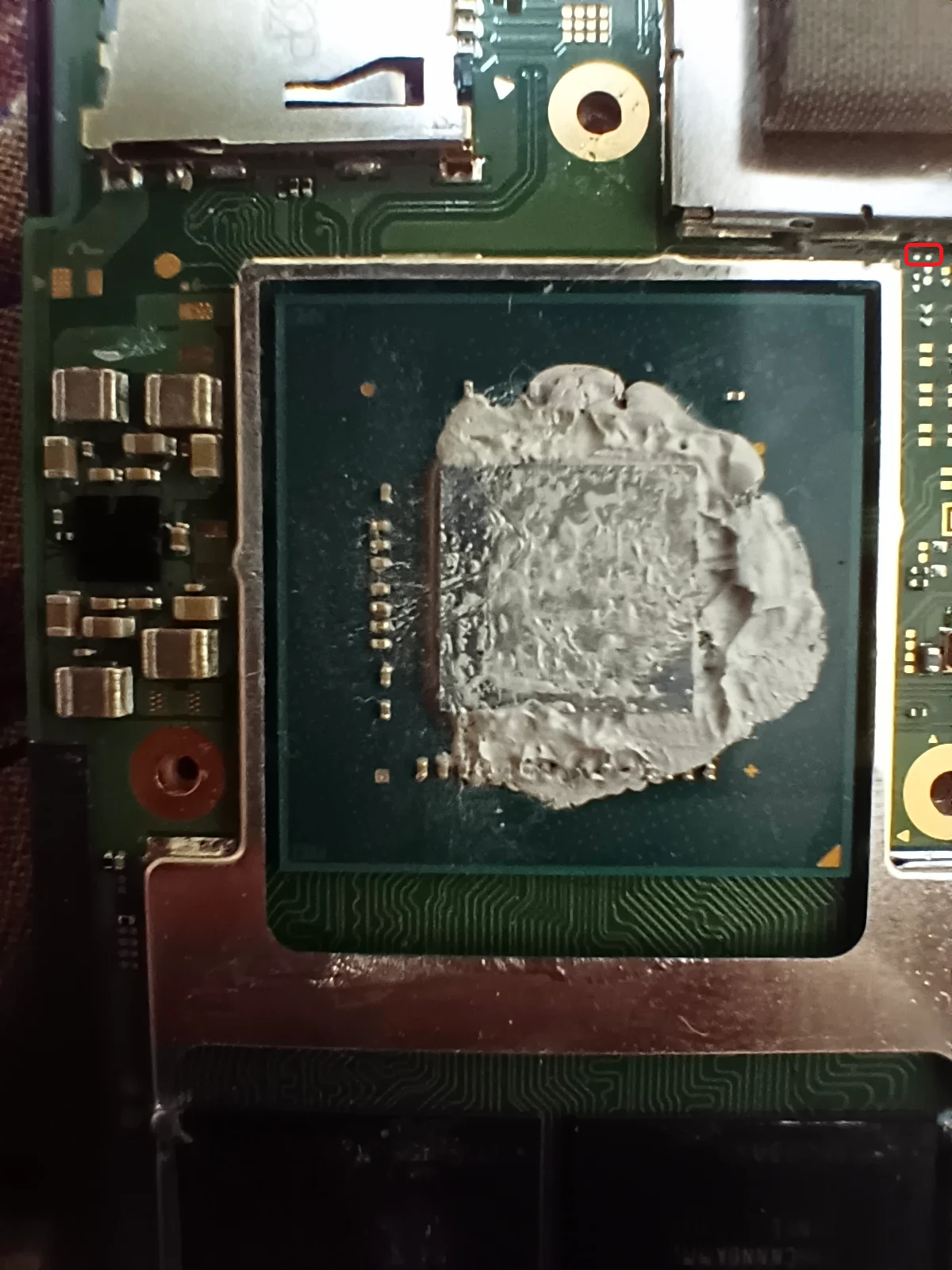

I am getting BSOD after trying picofly. I just applied solder to tge solder points and thought I will complete it in daylight.
Went through the forum, cleaned my soldered points and flux but still BSOD.
Attaching images, please someone have a look at it.
Missing resistor. I believe it's 100 ohm

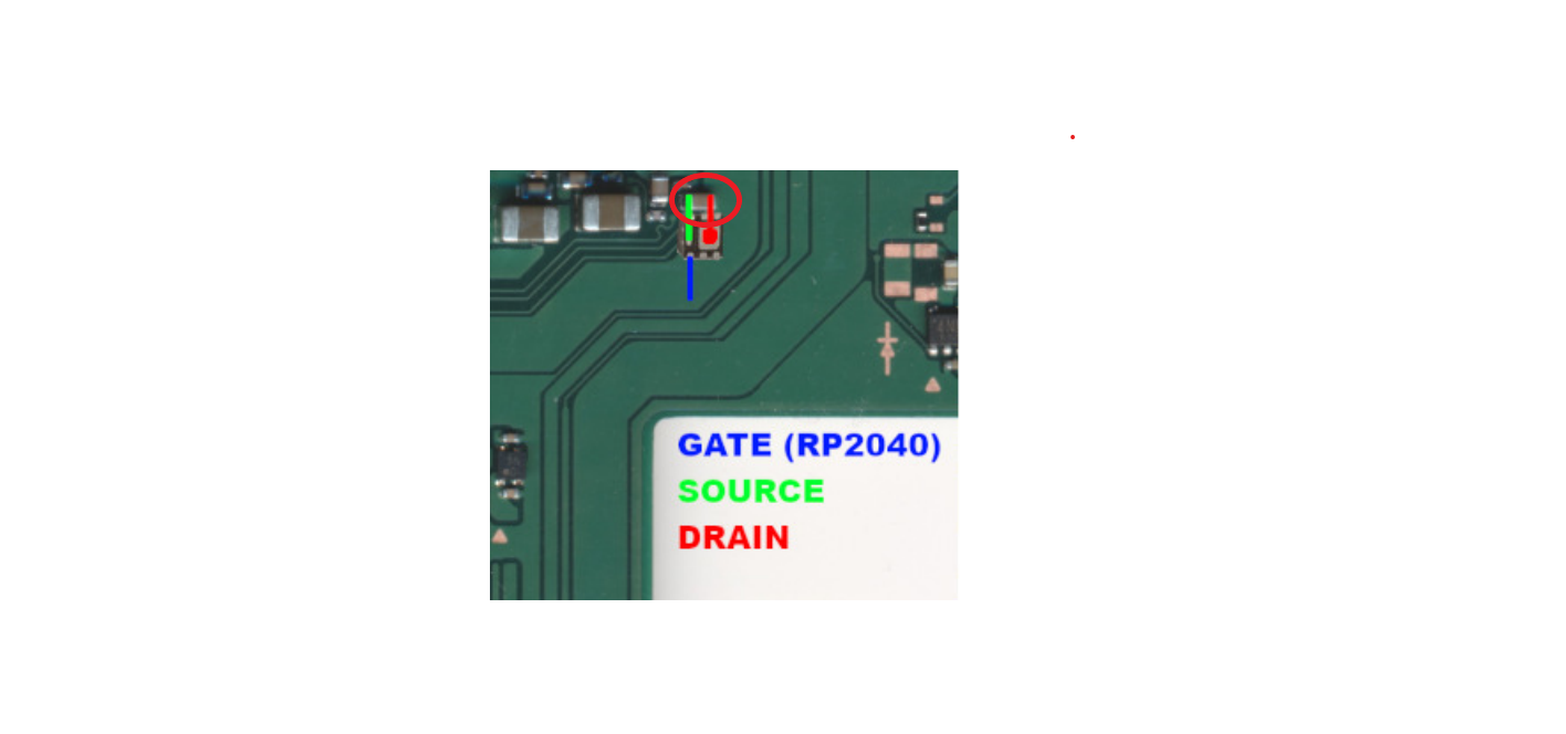

I changed from flex cable to backside mosfet installation which works fine. Just in case I will ruin the cap near the mosfet on an OLED. Can anyone help me what cap it is that I can order some spare sparts ?
or you can do this install instead

Great! Thanks for that info. This is only working for OLED or are there also safer methods for V2 / lites etc. for the mosfet installations ?
there are, but you normally wouldn't remove the motherboard on those so it adds complexity in other ways instead. Here are two alternatives for the switch lite
See this post https://gbatemp.net/threads/picofly-a-hwfly-switch-modchip.622701/page-579#post-10200708
there should be similar positions for v1/v2, I didn't check. Having to remove the motherboard makes it not worth it for me
