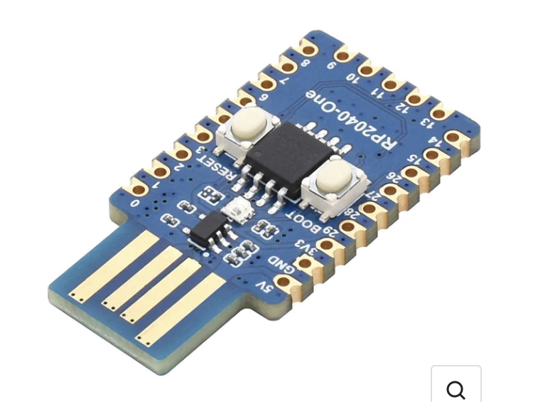

I don't know what's up with this, but nothing I do results in this chip booting Hekate or any other Mariko payload. Always the same LED pattern, always indicating success, never actually booting. Resoldered all points 4 times, tried with and without resistors, even tried exFAT vs FAT32, no difference whatsoever. Removing one point results in the Switch booting normally (then bootlooping as the chip tries to reset it) but with all lines soldered it's the same blue > light blue > white > green and the screen remains black. Payload is always named payload.bin and placed on the root of the SD card. Without it, I don't get a "no SD" screen either.

This would fit inside I think inside v2 Mariko.. og pic has usb de-soldered

Same problem here. Flashed .uf2 (1.1 unlocked Ubuntu one), soldered all points correctly to switch lite… aaaaand yellow led at the end :(. Tried several times, several rp2040, with and without resistors (0806 smd 47ohm) same thing. Used np2016dr mosfet (taken from hwfly V2 flex) - soldered with enameled magnet wires according to the diagram provided - no hekate, just a black screen with no backlight. With hwfly V2 flex and hwfly lite flex - ALL the same yellow led at the end of chip working :(. After all, I’ve soldered the same wires directly to hwfly lite chip and it all worked like a charm (so it is not the soldering problems :(((

Hi, no the only one thing that was not made is bridging led mode pins, but I really think it will not affect at all. May be length and thickness of wires can really be the problem. In original photos from first leak, we saw short and thick wire going to the cpu flex from rp2040, soldering was very poor, but wires were massive :))). I used 36awg and it was about 4cm long. Seems that can be a problem. Anyway, I left any attempts for future, nowadays I have too much switches to mod with existing hwfly options :)

Interesting. I had the exact symptoms you did (yellow/orange LED and black screen) but only when the LED jumper was closed. If yours was closed also I would have assumed we were seeing the same error. Oddly, the only difference the LED jumper makes in LED color seems to be the final LED color after what I assume to be the "preparation stage". Even weirder, I can't get it to show a specific error based on removal of a specific line, leading me to think that the error lights list we have is for a different firmware version than we have, one with significantly more error checking and error recovery.
