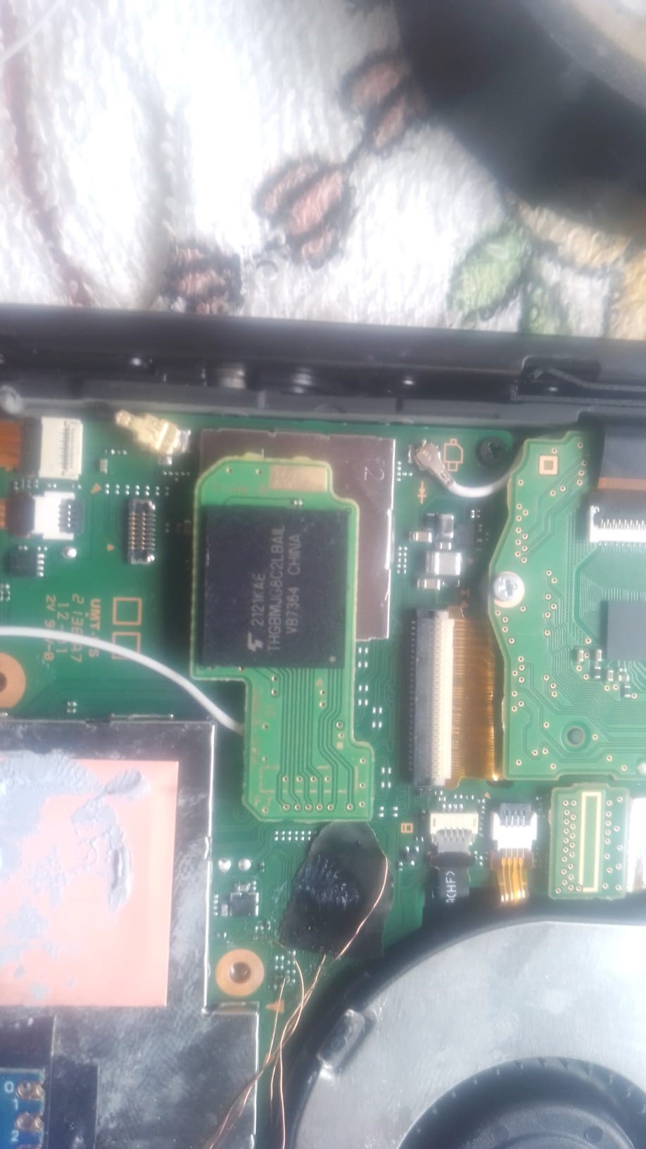

Hello, I have a v2 that glitches but does not start the unlock, also sometimes it starts original as if it did not have a chip. I have tried various chips, the chip firm is 2.74. Does anyone know if that nand is problematic?
FW 2.74 was removed because it is not stable. Try to flash the 2.73
tried
