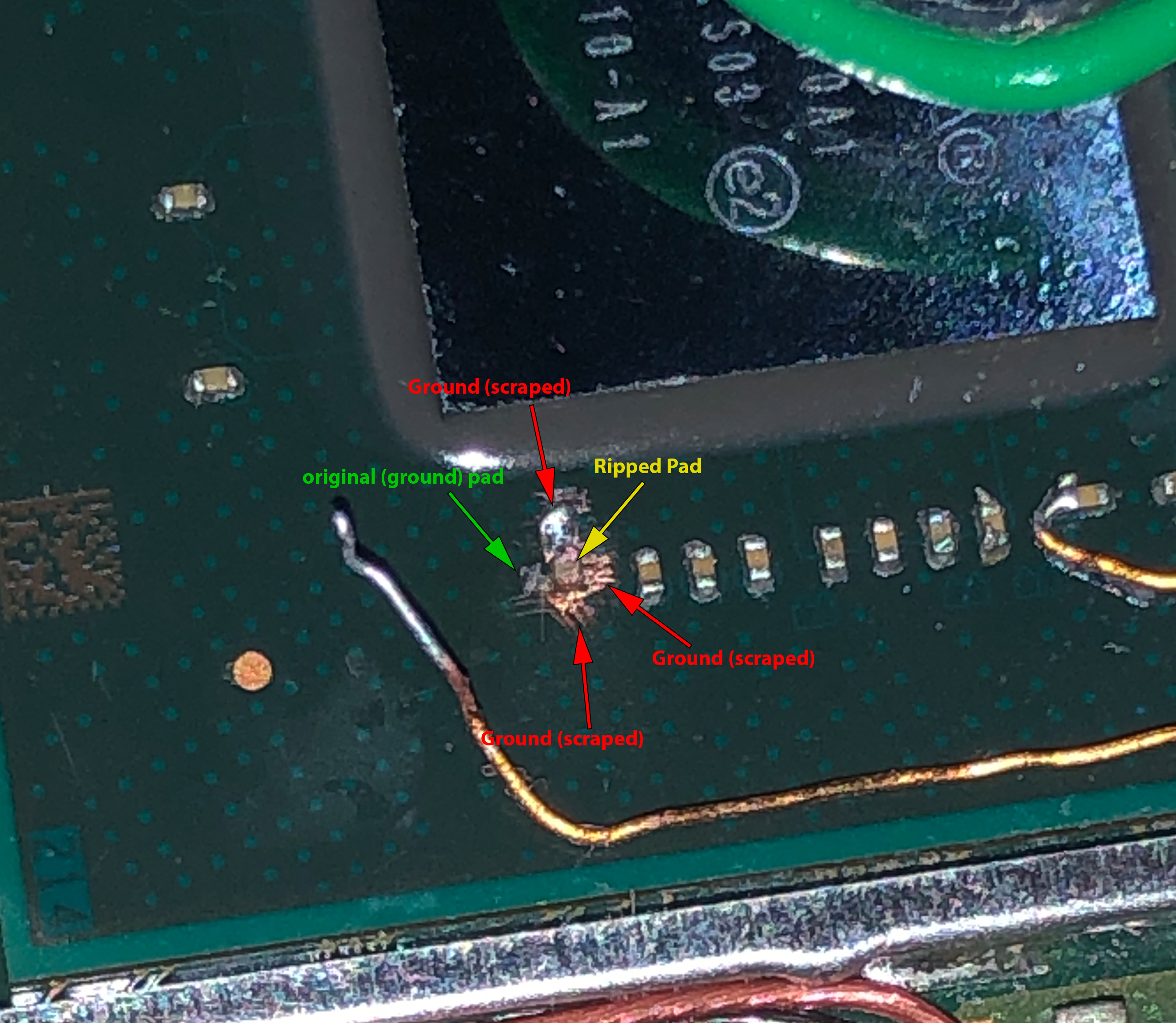

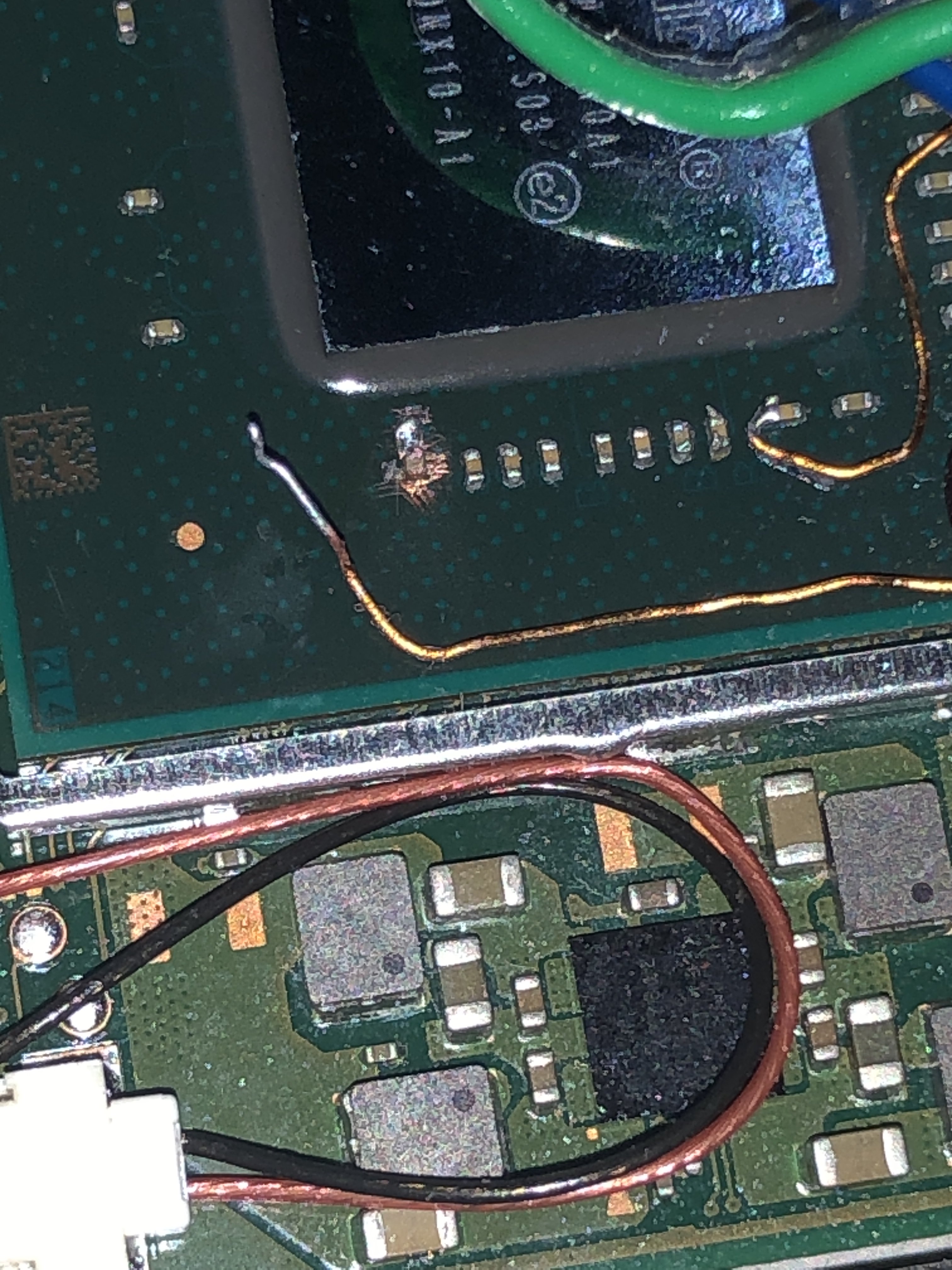

hey all! I've got a problem with my second picofly installation on a mariko (v2).
I've done one very successfully.
one of the drain wires of the mosfet to the furthest capacitor beside the nividia chip detached and took the capacitor's pad with it! (yeah... ripped pad).
As you can see in the picture I attached, only the capacitor's ground pad remains, and I've carefully scraped all around the ripped pad to find a possible continuation of that ripped pad. Turns out there is ground all around this pad (checked with dmm)
I tried soldering the wire to the capacitor's ground pad but I get two long yellow flashes and one short yellow flash (==*) which means check mosfet I've read.
My question is, what can I do now? Is there any alternative solder point for one of the mosfets' drain?

Basically you only need one. Those two cap are connected one to another.
There still capacitor on the right. The problem is you need a bigger cable, since there will be high current flows in there. I make a U-Turn to make it twice the current could flows.

now I get =** (=** eMMC init failure during glitch process) :( and it doesn't even go into OFW (black screen). Have I destroyed the switch?

Both cap actually connected. VDD connected to each other and GND connected to each other. Something like this (pardon me for the bad sketch)
Basically the mosfet is used as a 'switch' to steal the power that goes to the soc. As long as the mosfet could hold the current flows there, then adding another mosfet to the same point is useless. Its just the same as adding another cable to split the current, so the maximum current flows is twice than before.
IRF8342 could hold 8.5A, i assume its continuous. So if its only short time, it could hold more. If ship happened, then the mosfet will burned. Since it is not, then the mosfet could hold the high current flows to DS.
ok ill give it a try with a single mosfet. can you post a pic of your single mosfet install?
