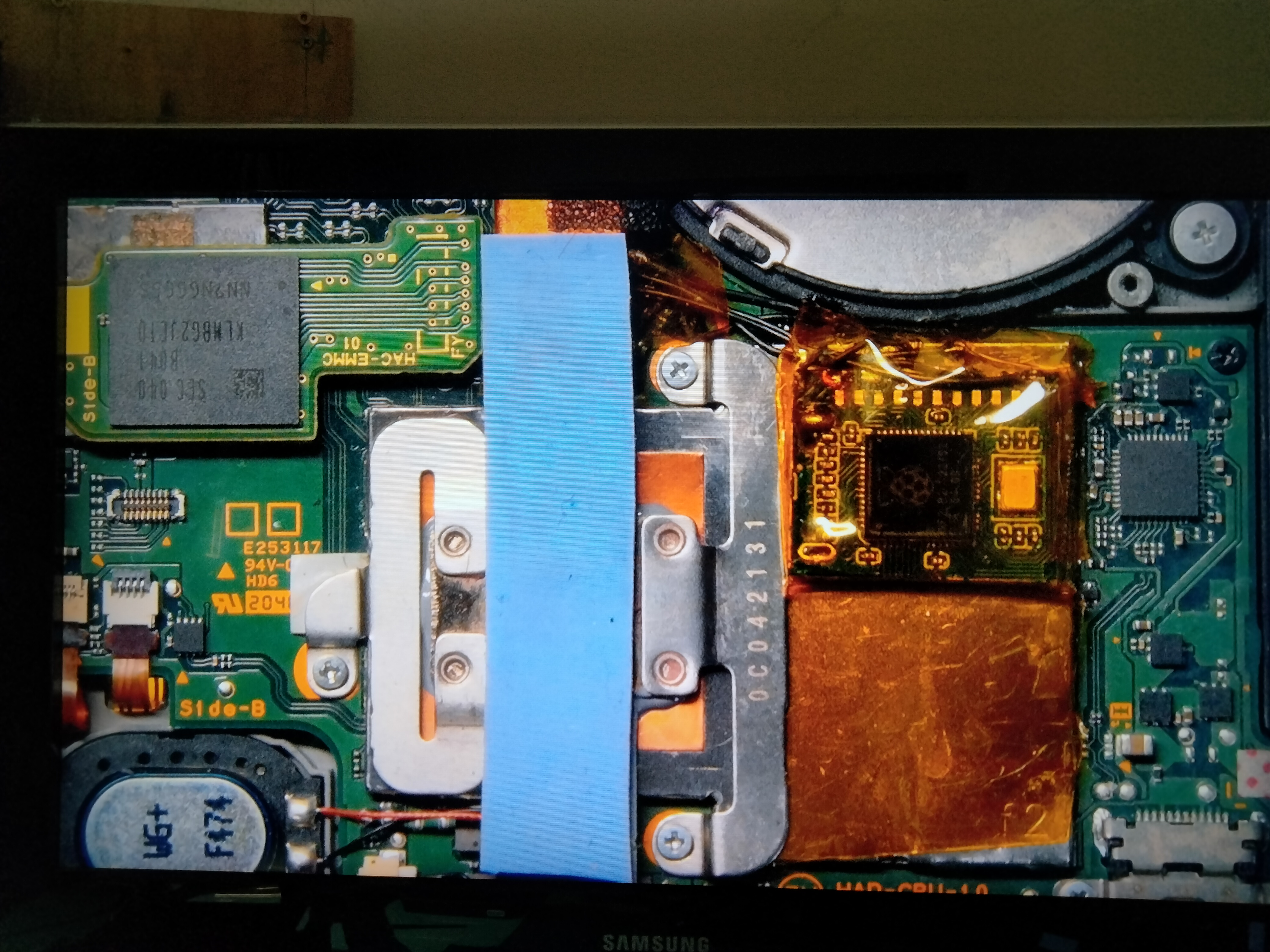

I did another lite today. Forgot to disconnect the battery, which made the mosfet burn as soon as I connected cpu+rst wires to the chip. Replaced it and everything worked fine, so I guess I was lucky I didn't short anything important during install. Install time down from 6 hours (first one) to about 4 (second one). Not burning mosfet would have saved me another hour, troubleshooting takes time.

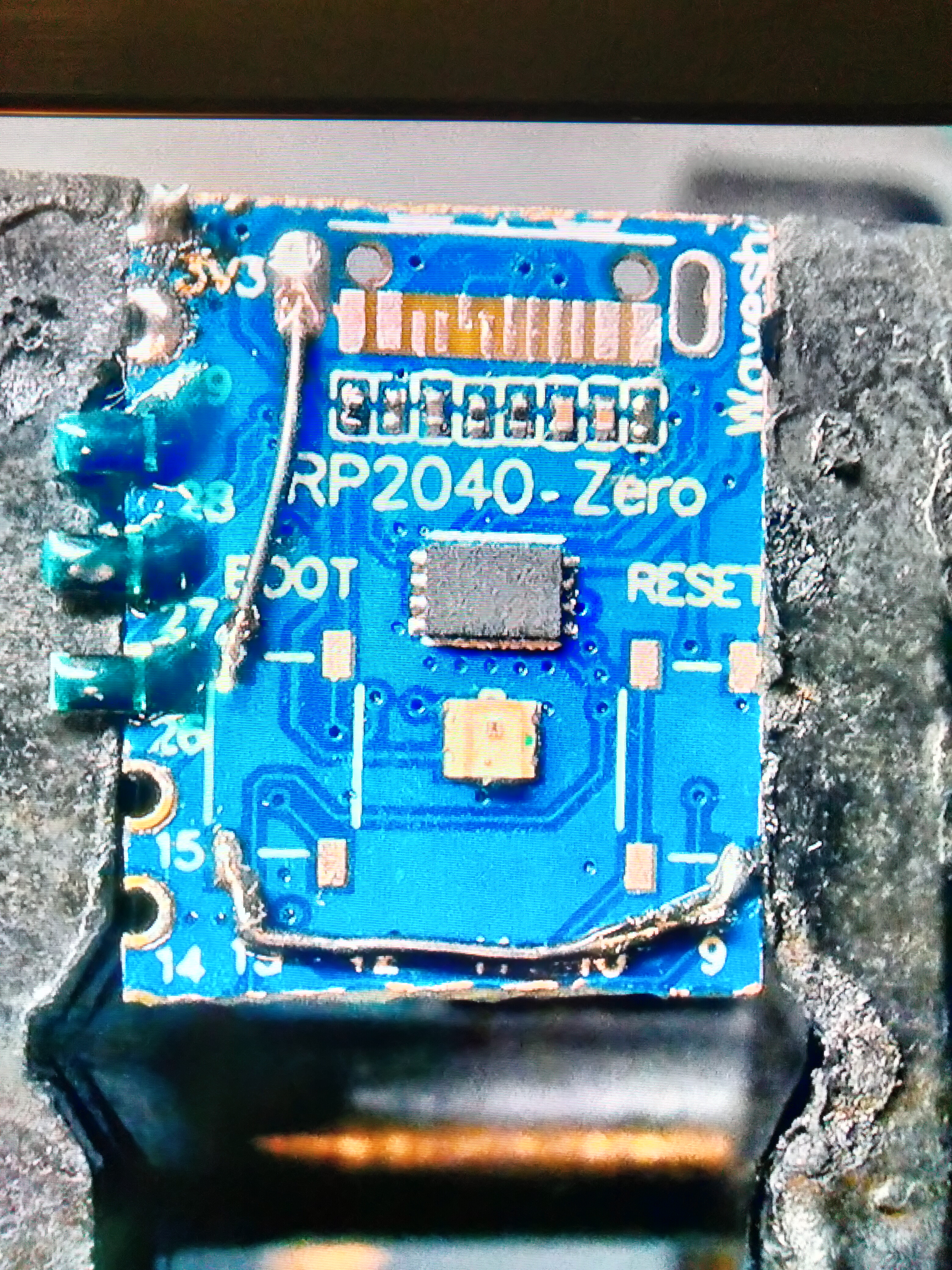

Made some little tweaks to the PZero board with some shears. I like it.
I flipped the chip upside down to try and reflect off the shield, it's visible when you really try to see it. Glitches too fast to see anything most of the time anyway though. Fk yeah @rehius!
NSFW\TRIGGER\GORE WARNING
Bro what are u doing with that poor zero..... That pootrthing was so beautiful hahahahahaha
