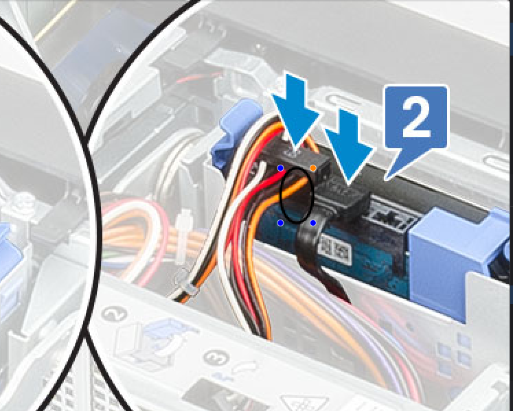

I took a Dell Precision 3630. It could boot up using my SSD, I could install TrueNAS and all. But it seems like it couldn't detect my other HDD. I troubleshooted everything I could (BIOS SATA options, was there enough power from the PSU (460W), were cables properly plugged in). Everything was fine, but when I mentionned the PC model I had (Dell Precision 3630), then all answers came out. Proprietary cables. To be sure, they asked me to plug the SATA/Power Sata cable in my SSD. This time, it couldn't boot pass the BIOS (no OS detected). It confirmed it was proprietary cabling, that it couldn't detect my stuff for whatever reason (could only detect Dell Sata input plugs? I don't know) In any case, I'd prefer to avoid any other surprise. If I change the PSU, am I going to face "unwanted surprise"? Or should I just return the PC and get another one without "this shit"?
It *looks* like just a standard ATX power supply, so I don't think you should have any issues swapping it for any other normal PC ATX form factor power supply? Pinout seems to match ATX spec too based off of the wiring color on the 20+4 connector. https://www.dell.com/support/manual...bdcc09-4a5a-4ac6-99a1-65b8d718900d&lang=en-us
MAJOR word of warning - if you do end up swapping the power supply, DO NOT REUSE the modular PSU cabling that that factory PSU looks to use. Even if that cabling plugs in to whatever PSU you end up replacing it with, there is no standardization on the pinout at the PSU end of things and if the pinout does not match you will fry most/all connected components. Only ever use the cabling that is included in the box with a PSU.
Something you should try before raplcing the PSU though - I have a hunch that what you're seeing is the "3.3v reset issue" , basically on server PSUs they can turn on 3.3v to the HDDs individually to reset that hard drive, which some hard drives support and some don't. Consumer PSUs though can't control that and some of them will just always send 3.3v to the drive on those pins, and on drives that are controllable like that, will cause the drives to always be stuck in a "reset" state. Take a look at this guide on imgur, you can tape over the 3 pins on the drive closest to the SATA data cable. This is safe to attempt on any drive, it'll either do nothing or it'll fix your problem. You could probably use masking tape if you don't have kapton tape, but it might be too thick. Maybe a piece of scotch tape/cellotape instead?
Edit - if it is the "3.3v reset issue" then it's a total crapshoot on whether a replacement PSU will do the same thing, btw, as it's as much dependent on the HDD/SSD supporting that "reset feature" as it is on the PSU sending 3.3v to that pin. So if that is what is happening here then ultimately you could still run into it again, until you either get a PSU that doesn't send 3.3v over SATA power, or get a HDD/SSD that doesn't care that it's being sent 3.3v
https://imgur.com/a/3-3v-pin-reset-BFdmB
Or if you're *really* certain that you don't care about the PSU anyway and are likely just gonna replace it and don't want to futz with taping over connectors, you could just cut the orange wire here upstream of the first SATA connector (turn the PC off / unplug from power before you do this please). Tape it up on both ends so you don't have any bare wire floating around to short on something. That will accomplish the same thing as taping up that pin on the HDD, just cutting off the 3.3v feed from the PSU instead
Edit - I'm not sure if where I circled on the picture is between the first sata plug and the psu, or between the first sata plug and the second because it doesn't show me enough of the cable there lol. You want to cut the orange wire between the first sata plug and the psu
