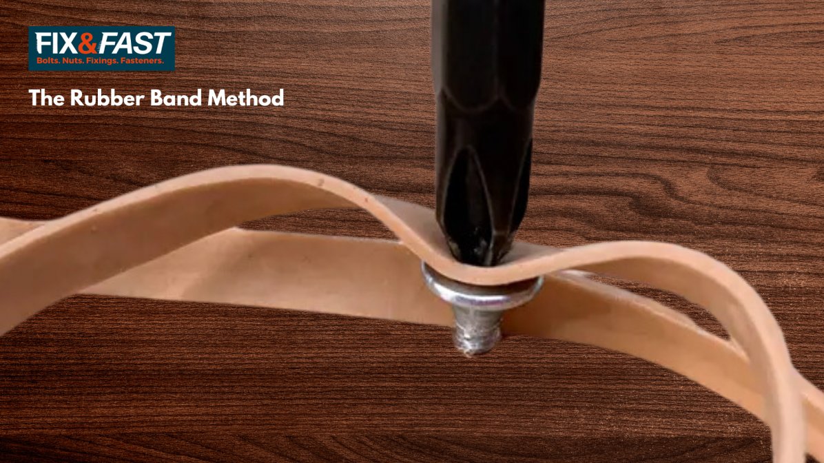

These are the stripped screws, I have also tried to remove the other screws with a PH 000 driver and they also are becoming stripped, ill include images!
I am looking into how to remove stripped screws, does anyone know a good solution!
I am currently ordering a backplate which comes with a different screwdriver, may try and get a rubber band too!
These are methods #1, #2 from IFIXIT, #3 pliers probably wont work as the screw hasn't budged much!
Anyone got any help to offer?
This obviously depends on how badly the screws are stripped and I know those Switch screws can be tiny, but a method I've had success with in the past is to use an elastic/rubber band in-between the screw and screwdriver. This can sometimes give you enough tension to rotate the screw. Good luck!

Unfortunately i tried this method and it didnt work, the middle secton screw on the joycon rail of the switch are screwed in so tight!
Just need to figure out which drill i can use etc.
Thanks for your reply though, i heard this method was successful for some people

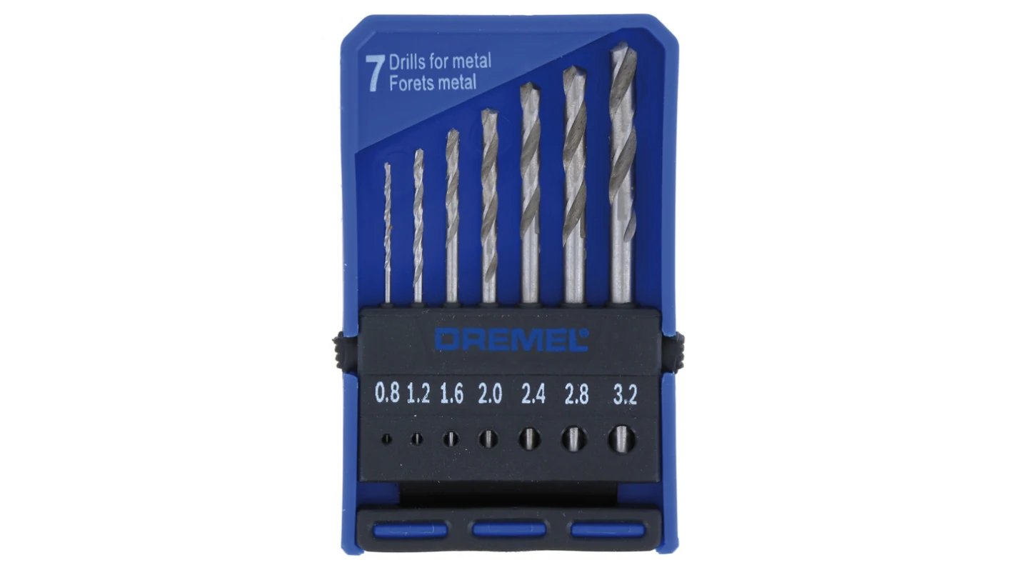

I used a dremel. It's a little easier to control than a drill. Used the precision drill bit set from Dremel that has sizes 0.8-3.2mm which is perfect for things like this.
I had to drill out one of the very same screws myself. It was stuck from the factory.
The drill bit set looks like this (Dremel 628)
I forget which size I ended up using, it might've been the 1.6.
Thanks a bunch, ill try and get that then
Is that all i need to extract the screw part?

I would say use Y00 and P00 bits
And the dremel itself.
Ok, thanks for all your help, final question before I order and give it a try!
Which Dremel drill works best with these "Dremel 628 Precision Drill Bits" out of interest?
Dremel 3000, Dremel 4250, or Dremel 8260, all seem to be compatible!

I got the 3000, the difference is only in how powerful the motor is, I don't need it often and I figured I don't need the most powerful one for the things I do. And the price difference is significant. I did get one that came with a pouch and a few tools already included.

Just came in today, the 3.2 fits but I see I need a different sized collet (holder) for the smaller drill bits!
Will Dremel 4485 Collets Kit with 4 collects and 1 collet nut be what I need?
Or Dremel 4486 Multi Chuck (0.8 - 3.2 mm) ???
I think Dremel 4486, as it says it works with every size but I just want to verify with you first...
Thanks for all your help so far!
Update: So i was able to get the back plate off finally, followed the rest of the guide, put the new battery in and put back in microsd card and boot to hekate!
