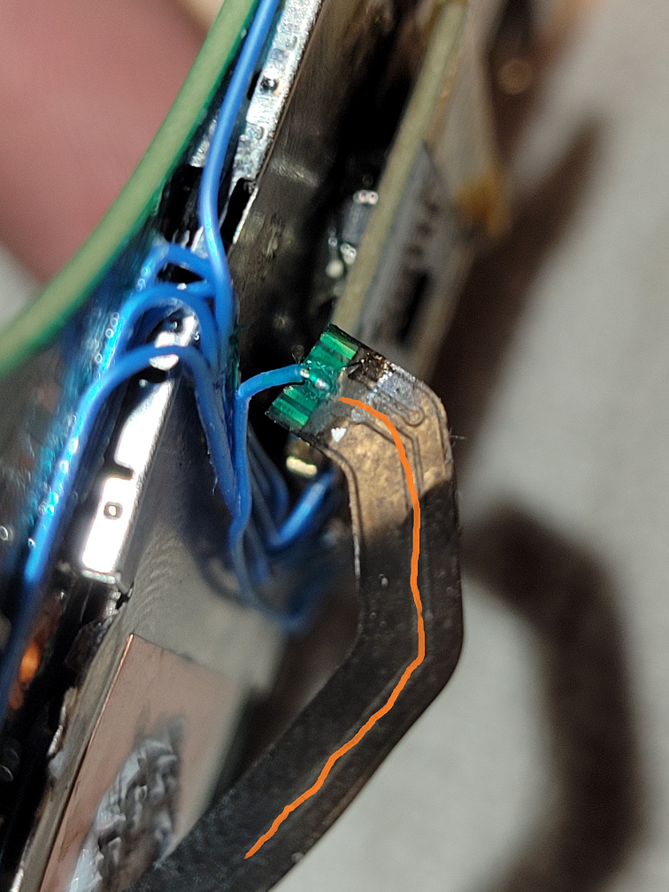

Here are some pictures of the install:

close up picture of SP1 SP2 soldering please
Wire broke off from the ribbon cable after I took the picture. Should I resolder it to the same point?

sp1 left side seems broken but that's ground. The right side not too clear with maybe thermal paste on top. The sp1 cap seems twisted not straight compared to how sp2 cap looks like
this middle entire line is the CPU pin to rp2040, do whatever you want.

I disconnected all the wires from the chip and the console will still not boot to OFW. Would that mean the CPU is likely dead?
CPU will not be that easy go dead, But you have permanent dat0 soldering so I don't think that would be data corruption either. Maybe other hardware issue
