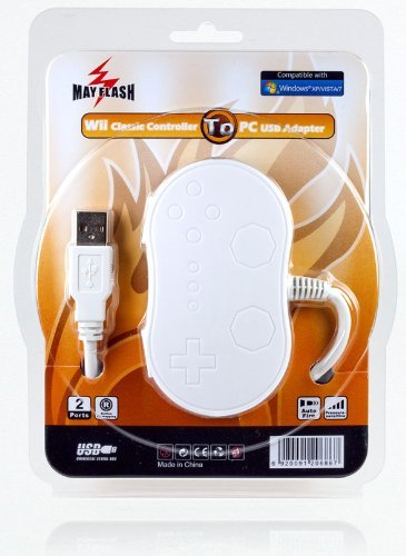

PLEASE HELP!
So I have this, the classic controller pro. Will it work with Nintendont with the Mayflash adapter?
This one: http://www.amazon.com/Wii-Classic-C...71&sr=8-1&keywords=wii+classic+controller+pro
Also, I got the bluetooth Mayflash adapter. It's the one where you plug in the controller and then use a bluetooth USB for input. Just ordered it in fact. Can I use it for Nintendont or do I need to wired one?
Wireless
http://www.amazon.com/Wii-Classic-C...r=8-1&keywords=wii+classic+controller+adapter
Wired
