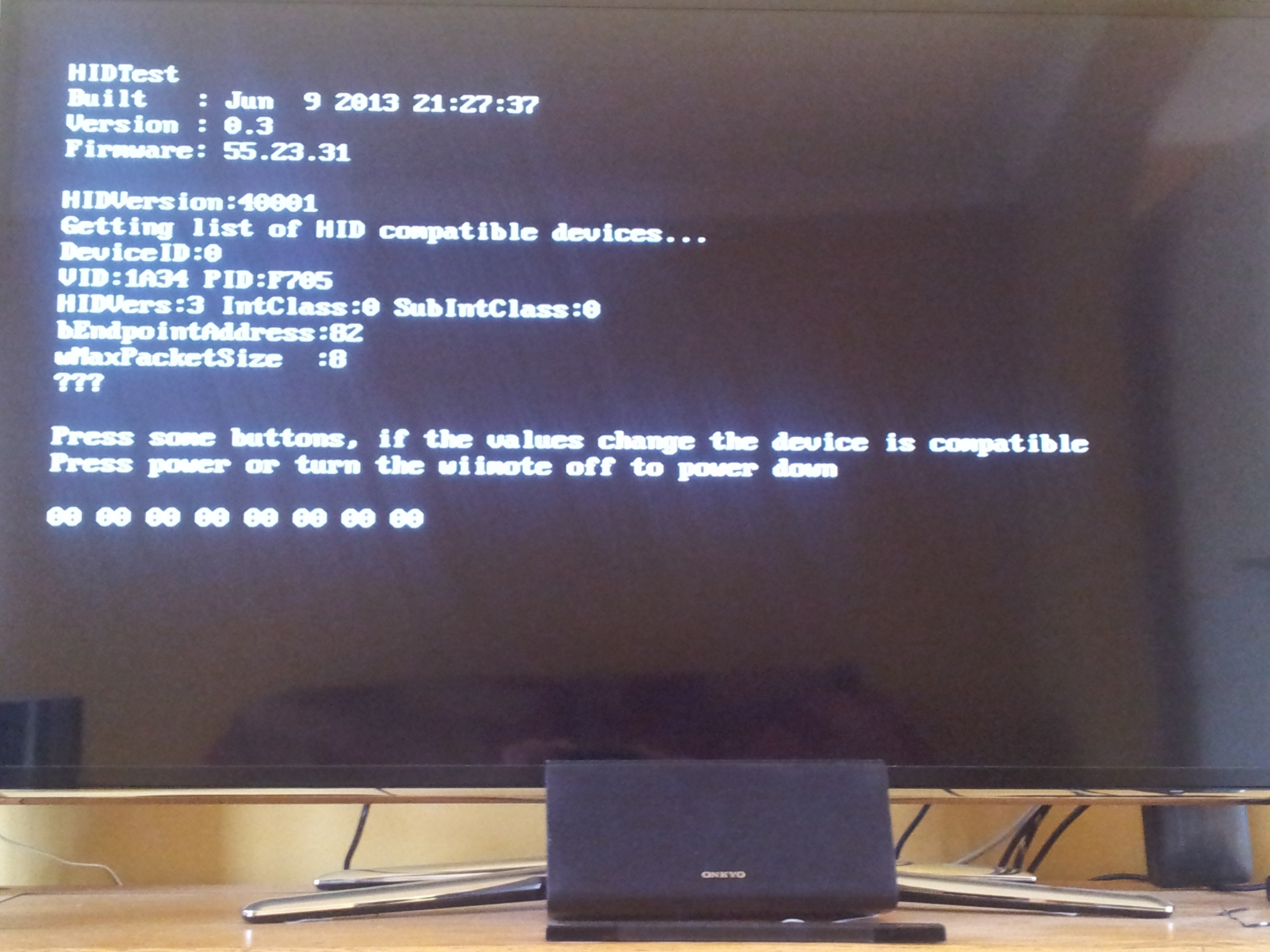

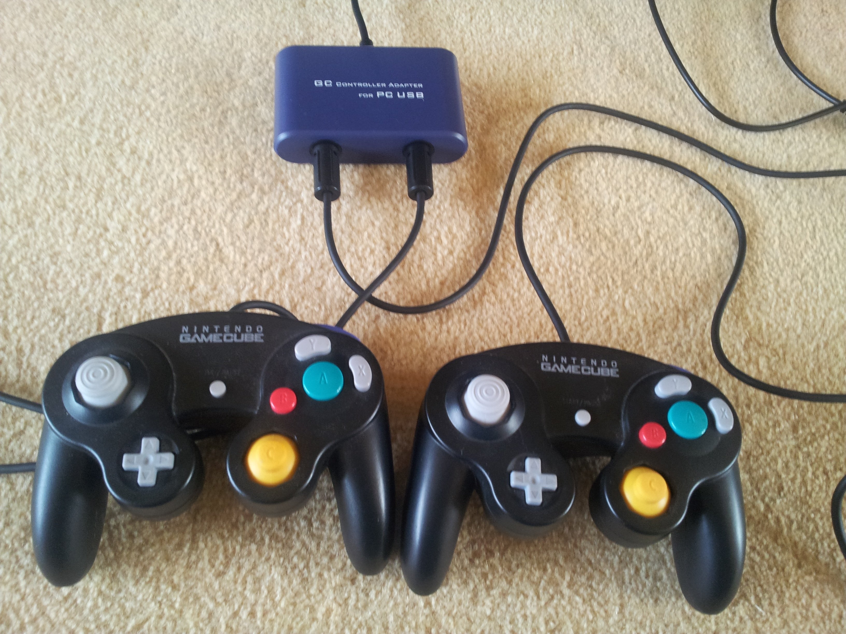

I have one of those usb-gb converters. I tried with both front and back USB and had two controllers attached (tried with 1 too). Version 3 of the program has the following output attached. While version3b crashes with an exception.
When trying the controllers nothing happens.
I did get a nes retrolink controller to work though.

Yep, exactly the same for me.
