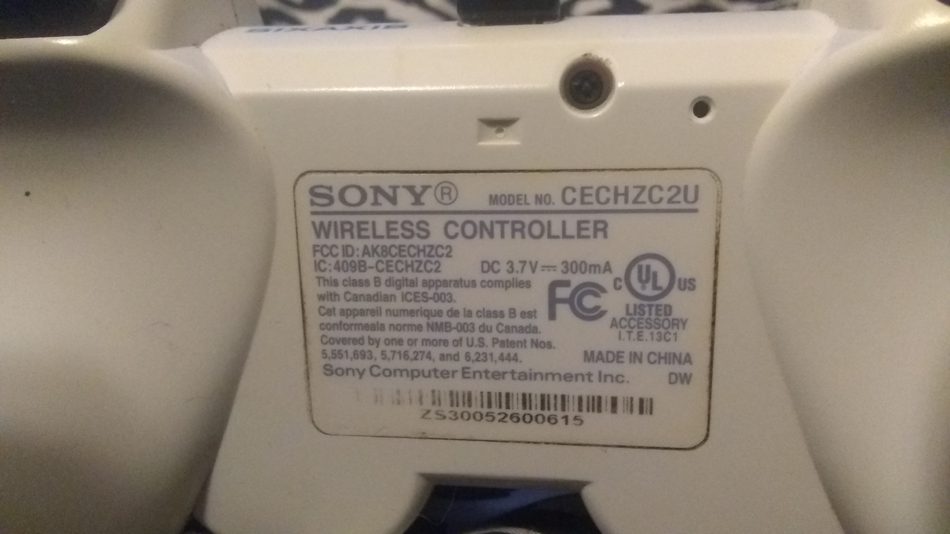

I have a ps3 and two new ds4 controllers when connecting to nintendon't none of them have rumble. I believe when I had a Wii my ps3 controller would have pressure sensitive triggers and rumble when using nintendon't. Got a Wii U just to get nintendon't and be able to play Star Fox Adventures again. Does anybody have the correct controller ini for either controllers or tell me how to get the value and I will try and do it?
i dont use any controller ini and my dualshock3 rumbles just fine on nintendont 491, be aware that if they are fakes/3rd party they probably wont have the same codding i guess, or diferent models too, since i think there is diferent dualshock3 controllers out there, mine works just fine.

My ps3 controller is real I believe. It is the white one and has Sony on the front and back and has DUALSHOCK 3 and SIXAXIS on the top so I don't think it is third party or fake. If you can help in any way I would be grateful.
Model number: CECHZC2U
FCC ID: AK8CECHZC2
IC: 409B-CECHZC2

My ps3 controller is real I believe. It is the white one and has Sony on the front and back and has DUALSHOCK 3 and SIXAXIS on the top so I don't think it is third party or fake. If you can help in any way I would be grateful. Model number: CECHZC2U
FCC ID: AK8CECHZC2
IC: 409B-CECHZC2
mine is CECHZC2E so its a different dualshock 3 model i guess, mine rumbles and works perfectly fine without a controller.ini if i let nintendont just take over since you dont need a controller.ini for supported controllers, since rumble is hardcoded into nintendont maybe that model either doesn't use the same codding to rumble or its a fake controller, if you didnt bought it new in an official retail store you cant know if its not a fake, there are so many fakes its very easy to get one, i had a fake one that looked like 100% genuine the only giveaway was when i opened it up it had a Chinese battery and some weird trigger mechanism compared to the official one.
see this post he had the exact same controller and turned out to be a fake one

take a picture of your reset hole button on the back if you can.
