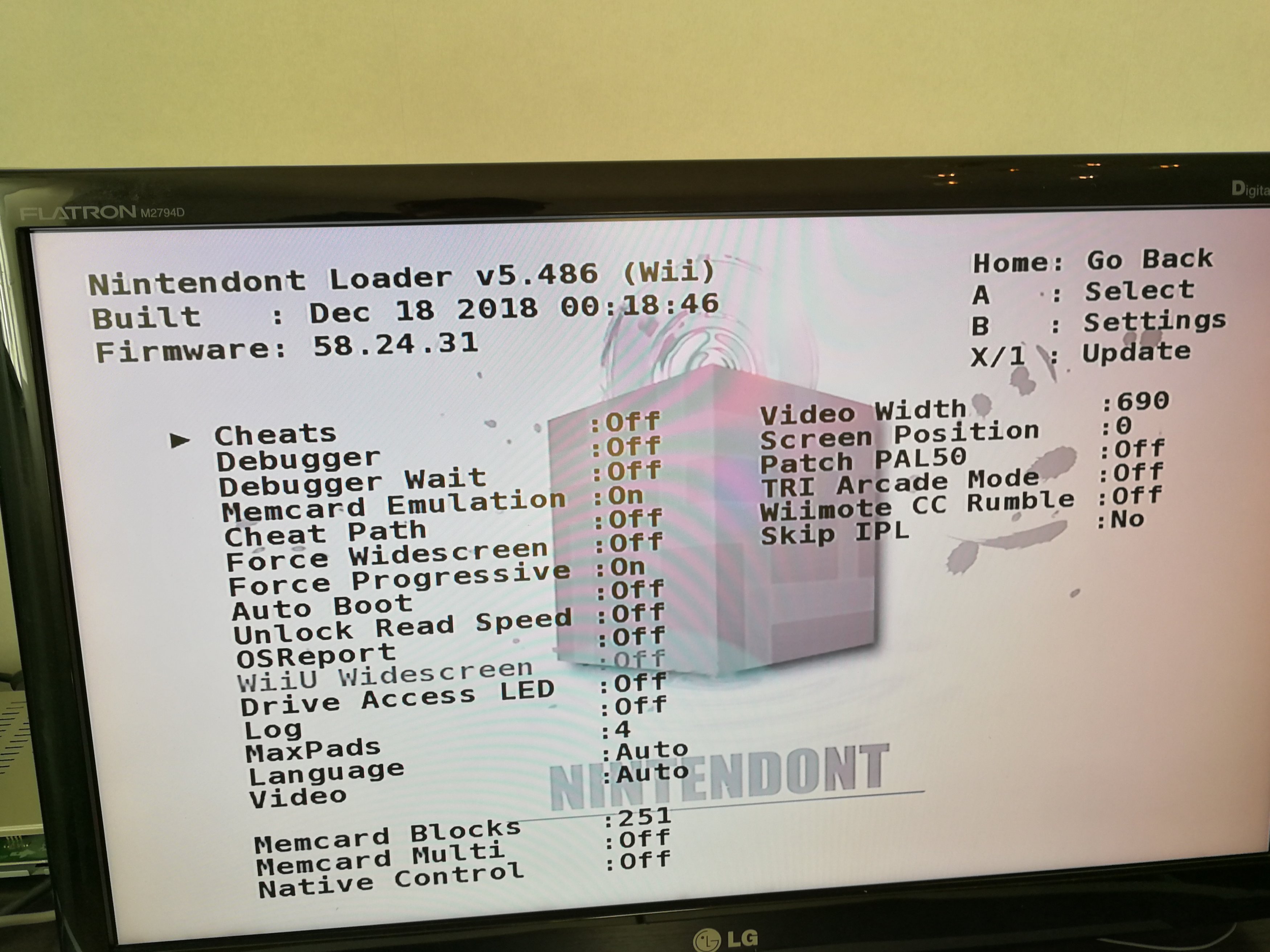

After years of hiatus I finally returned to the wonderful world of the Gamecube, and thanks to Nintendont I can use the Wii's component cable and force progressive on my original PAL games! YAY!
To my problem: when playing Eternal Darkness, the sound is acting up. The music is sometimes crackling, and now in chapter 4 the music is (in lack of a better description) "jumpy" or "laggy". The music sounds normal when I'm in the pause menu, but the problem reoccurs as soon as I continue playing.
I use the Wii and the game is an original PAL disc. I do force progressive, and also changed the video width within Nintendont, but the sound was weird even when these were set to default. Any help would be much appreciated!

so your using the pal disc directly? maybe you have an outdated nintendont version? or maybe its becuase you are forcing stuff?, tell me your nintendont version, also try without forcing anything.

The Nintendont version is 5.486 and firmware is 58.24.31.

any chance you take a picture of your nintendont settings?
Sure! These are the settings I use right now, with progressive on and width adjusted. Only difference from the test earlier is that progressive was then turned off, and width was automatic (if you want I can provide a photo of those settings too).

your using an sd card to run nintendont or usb? maybe sd/usb is slow and it stutters since eternal darkness is audio streaming and requires abit more speed, that or your disc reader is maybe going bad, you tryed using an iso on sd/usb to see if the same result aplys?

After the help and tips from you guys I now did the following:
- changed my SD card loading Nintendont to a newer one, which is also big enough for GC games
- put verified Eternal Darkness PAL iso on that same SD card, instead of using original disk
Result: the game not only loads faster but also no stuttering music as of yet!
So the problem might have been slow SD card. Later on, I'm going to try loading only Nintendont from the card and play from the original disk just to experiment.
Thank you guys, I'll come back if the problems return ;)

yeah audio streaming games requires fastest reads than normal so slow sd cards/usb devices do stutter and take bigger load times, not sure if your disc is to blame too, maybe try the disc with new sd card.
It's also possible it't the disc drive, not the disc itself. They do have more difficulty reading even good discs as they slowly wear out. If this game needs the data particularly quickly, it may just be struggling to keep up.
