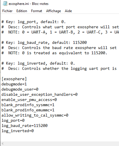

This was the exosphere file
Well I see blank_prodinfo set to 1 for both sysMMC and emuMMC but again, these would only have been applied if you booted CFW. If you didn't boot CFW, your PRODINFO wouldn't have been blanked.
