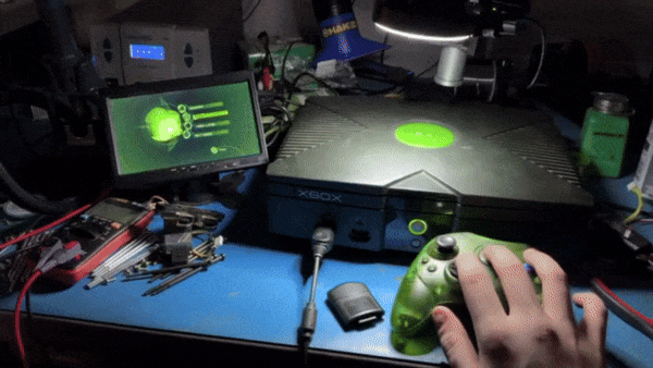

Thanks to work from shutterbug2000 and gaasedelen we now have brand new exploit called Endgame that not only doesn't require a Gamesave it doesn't even require a working DVD drive!

Copy the contents of the generated ENDGAME/ directory to a Xbox memory card such that the root directory of the memory card has the following structure, where payload.xbe can be any habibi-signed XBE of your choosing:
/helper/
/trigger/
/payload.xbe
To trigger the exploit, plug the memory card into a controller and navigate to it while in the dashboard.
After a few seconds, the system should begin cycling the front LED to green/orange/red to indicate success. This is followed by it launching the payload.xbe placed on the memory card.
