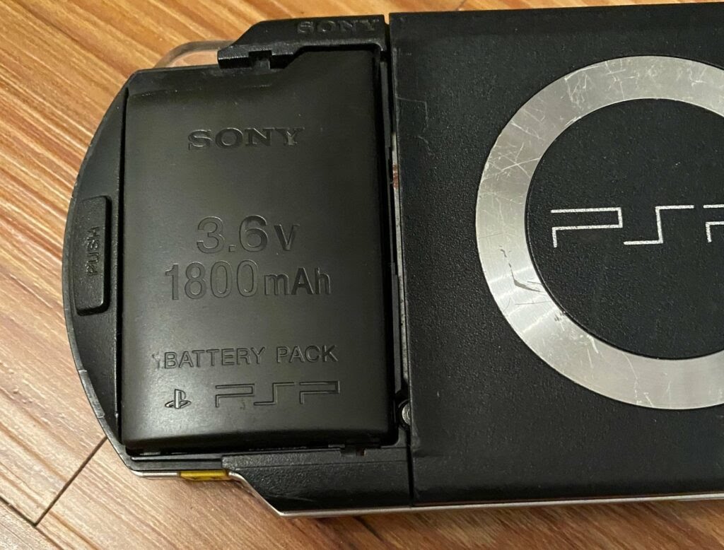

On the plus side, trying to find it, I just discovered my 2000s battery has swollen so badly the battery's case started to break.
This is a well known fact: these batteries, if not used for a long time and stored uncharged, swell enormously and absurdly...
Reactions: tech3475
Can confirm, the first time I tried to charge my 2000 up after a few years, it swelled until the battery door popped off.
I would like to point out that this only happens if you put away the empty battery. If, on the other hand, it is stored already charged, it will only lose some charge over time, but it will not swell.
Storing a battery fully charged is bad too, it should be stored around half charge. But if you leave it for years it doesn't matter, it will self-discharge until it's fully drained anyway.
Clarification: I also meant to say: set them aside already charged, not leave them in the console!
I'm well aware that they will discharge over time, but they won't deteriorate to the point of swelling. and then you can reload them again. The battery of my dear, old PSP 3004 is a perfect evidence of this.
Did I make myself clear? 😎
I'm well aware that they will discharge over time, but they won't deteriorate to the point of swelling. and then you can reload them again. The battery on my dear, old PSP 3004 is a perfect evidence of this.
Taking the battery out does generally help stop the self discharge since it's not powering the RTC or whatever else in the console anymore, but if I take the battery out chances are I will misplace it and not find it when I need it.
But it only slows down the self discharge, it doesn't change the fact that eventually the battery will still discharge below the minimum safe voltage of 2.5V and if charged up in that state it could swell.
I hope the OP isn't upset that I hijacked his thread, but I'd like to add something, for the sake of accuracy.
Most of the online testimonials report the case of the battery left inside the PSP unused for a long time, and then found with the lid broken and the battery already swollen. 🤔
I've never heard of it swelling afterwards, during charging: obviously in this case it was already swelling, but it wasn't visible yet...😉
