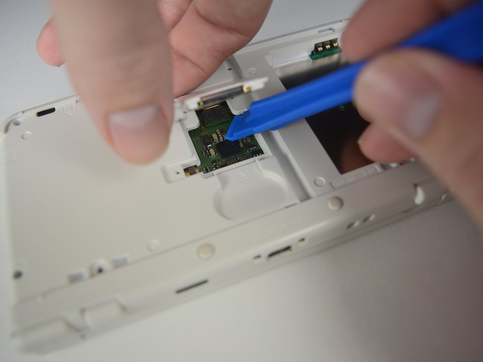

Yes, I can confirm I did it correctly. It's trivial to change it: a couple of screws and a plastic tool to lift the connector from the socket and it comes right off.
Pic from iFixit for reference.
I tried troubleshooting the same steps on both the old reader and the new one. Same results.
