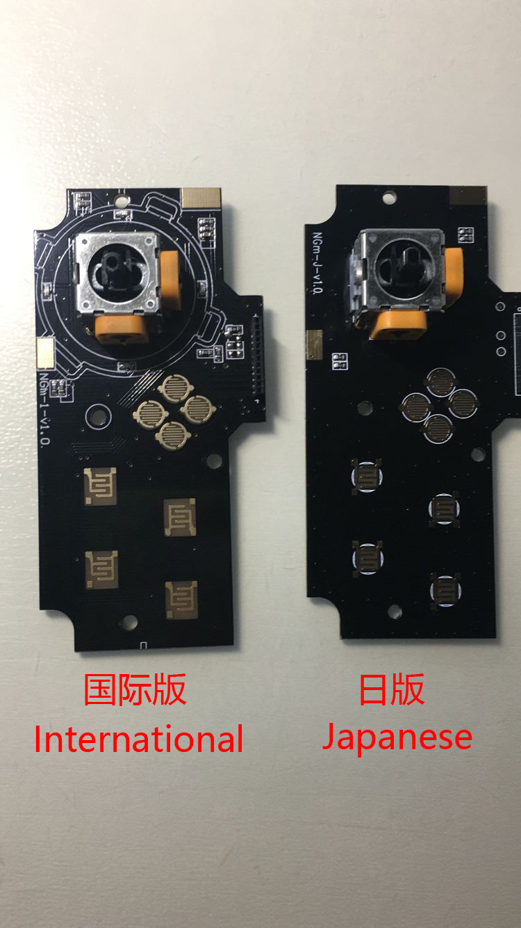

Thank you very much, Sir. The method is to replace all the four 10K resisters by 5K. I got it and I will have a try.
But, why is it a hardware bug. I used to think it should be a software bug.
I will replace it as soon as possible, and I will let you know the result.
I am getting to know why it is a hardware problem, because there are at least three different hardware version of the joystick motherboard. Thus, the system config must be modified to adjust the prameter of the dead zone for each version.
I am getting to know why it is a hardware problem, because there are at least three different hardware version of the joystick motherboard. Thus, the system config must be modified to adjust the prameter of the dead zone for each version.View attachment 169649
That actually explains a LOT... the ones I've flashed all have just the ngm-v1.0 tag on it Also I have seen this in the actual mvsnjemu code:
Which i've worked to modify and i'm in the process of compiling. Also i'll open up my Christmas edition today and get you the controller of that as well.
Side note, i've also added in a bios selector, and controller config menu... if that works out, you may not need to mess with the controller hardware itself, so wish me luck
