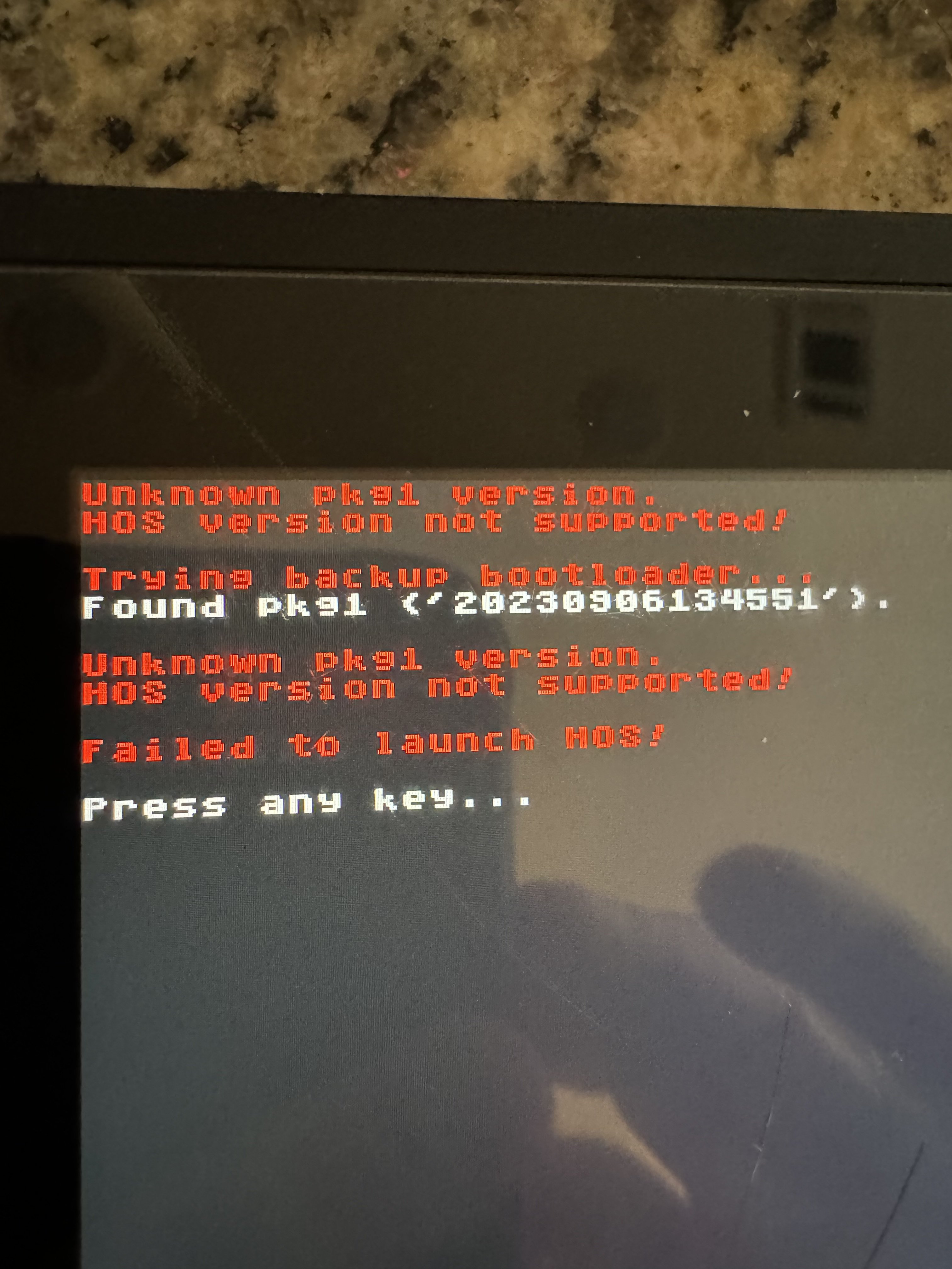

So I haven’t messed with the switch in a really long time. Everything was good until it wasn’t. I kept getting pop ups for updates and I would always click start software to start the game. But I fat fingered the start button to start the update. I don’t know what happened if it updated or if it didn’t. It was in airplane mode when all this happened.
OFW- ??? Have no clue what FW it was on before I sure don’t know what FW it is now.
Things I have done to try to fix.
I tried updating atmosphere and hekate all downloaded from sdsetup with no luck.
Any help is greatly appreciated. J
Sdsetup sucks. It’s not up to date. Downloaded updated files from the GitHub sites for atmosphere and hekate as well as new sig patches. All is working for now.
