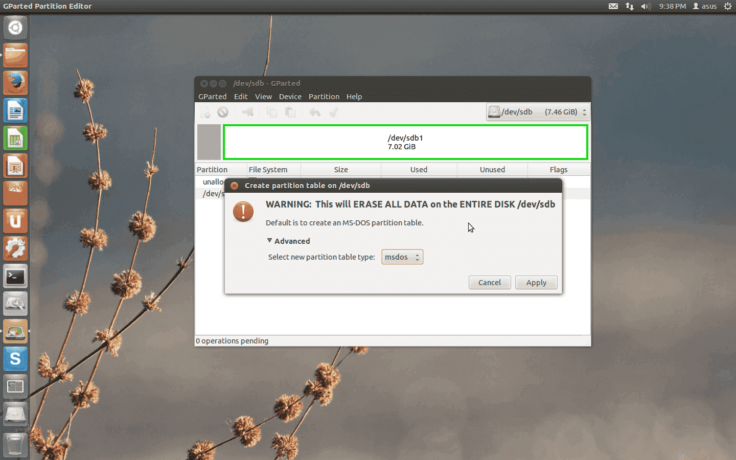

give me a moment i can provide you a picture for reference
linux doesn't work with drive letters, on the top right side, you can select the drive, select your hdd, you should recognize it from the size
to change the partition table, open the device tab on top menu then select "create a partition table"
in this picture example
/dev/sdb is my pen drive, as you can see its 7GB
(i made it smaller because this pen is dying\broken and attempting to write on a certain area at the end corrupts the files and gparted is a good tool to make a pen smaller so i could use this pen for not important stuff)
the partition table you want is MSDOS (don't get scared because it is the father of windows and you think this is old.. its says msdos because windows uses the same partition system as his father)
