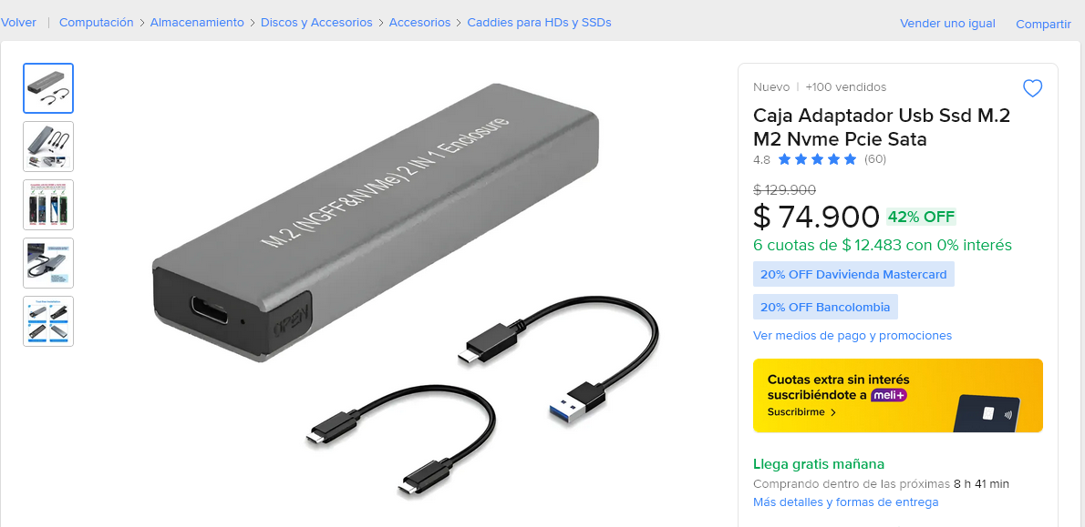

Well guys, I found this
on mercadolibre with one day shipping and a 42% off, so costed only 17 USD, so pull the trigger. once arrive, will try it with reflect. thanks a lo guys.
TBH if you've got this I would just do a direct clone.

sadly that model do not support SATA drives, the one I buy support NVME (PCIe) and SATA devices. :D
Well the USB Adapter has come, and with the great tool of Jayros Medicat, it is cloning just now
