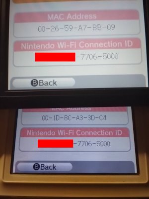

Update on this: I was able to clone the WFC ID using the DSi Wi-Fi Manager program: https://github.com/tasken/dsi-wifi-manager
Essentially, the WFC ID is stored in slot 1 for the wifi configuration, so as long as you have a connection there, this program will back up all the data in that slot which also includes the WFC ID. So I transfer my WFC config from one DS to this DSi, back it up, then transfer it back to the original DS and restore the backup on DSi, now you can have duplicates!
If you do this, probably best to avoid connecting these at the same time. Although this would never be illegal as you are allowed to transfer the configuration back and forth normally.
