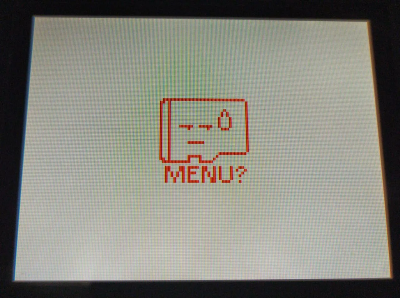

Hello there GBATEMP community,
I'm asking for help since I looked everywhere and I couldn't find the firmware for a R4 SDHC 3DS DSi Dual-Core Smart Update, but I found a user in here that had the same problem but not solved Would be appreciated if anyone has the firmware or any idea about it, thanks in advance and here's a link to the r4 images
I already tried this :( I need a firmware from the r4isdhc.cc which doesn't exist anymore and on wayback machine the files aren't saved
When you plug it into your device and try to load it, what happens? Do you seen an error? If so, what does the error look like?
Reactions: beyondyoussef
Looks like a DSTT clone.
Try this: https://github.com/DS-Homebrew/flashcard-archive/blob/main/files/Ace3DS+_R4iLS/Ace3DS+_R4iLS_Wood_R4_1.62.7z
Also, make sure you extract the firmware to the root directory. So in the root directory, it should have folder "__rpg" and file(s) "boot.dat", "_DSMENU.DAT" and/or "_DS_MENU.DAT".
...it's a DSTT clone, so why are you linking the Ace3DS+ kernel?
They should be downloading YSMenu: https://gbatemp.net/threads/retrogamefan-updates-releases.267243/.
It will also likely require some file naming as we don't know what file it boots from, which I can help with.
