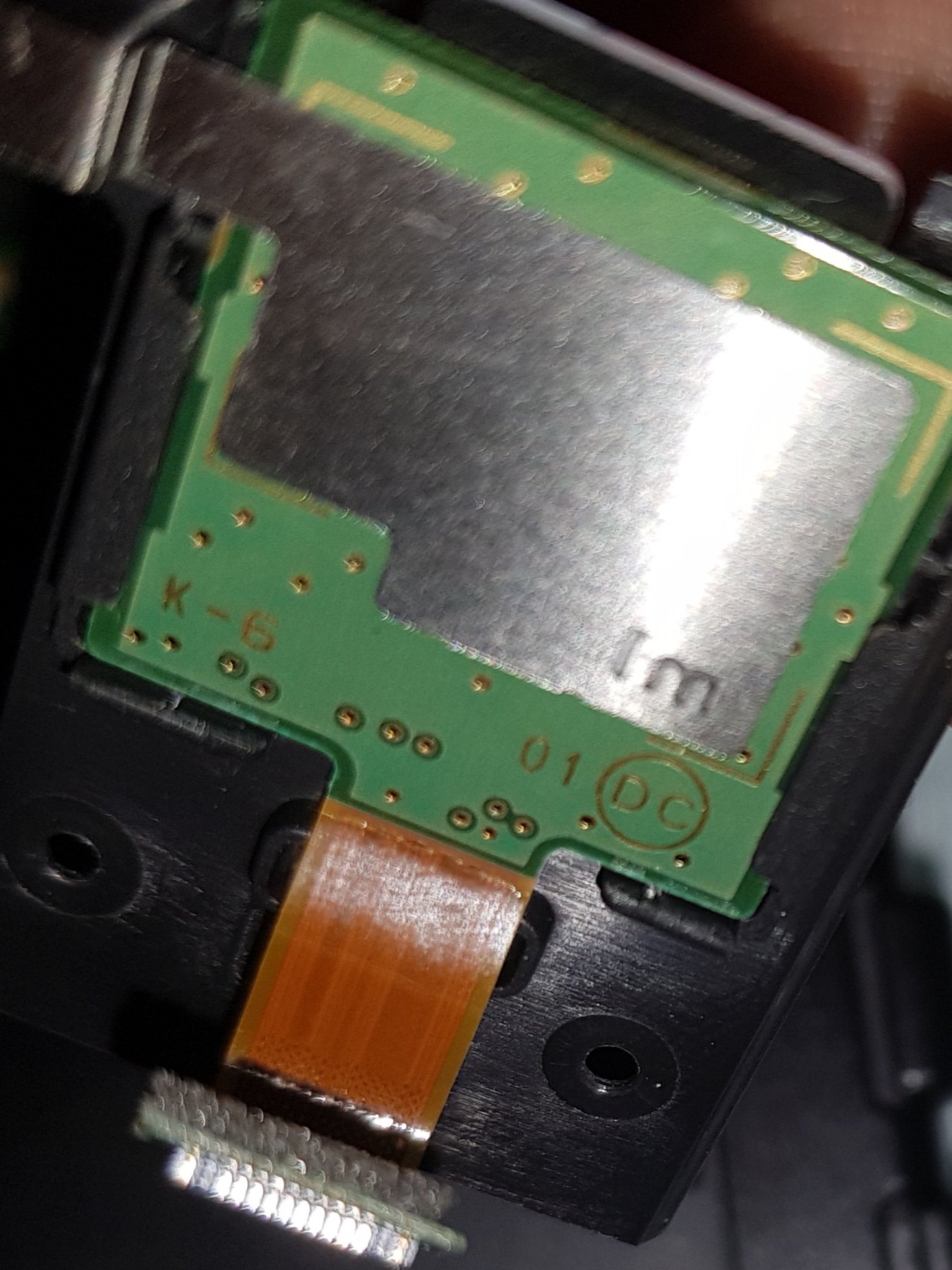

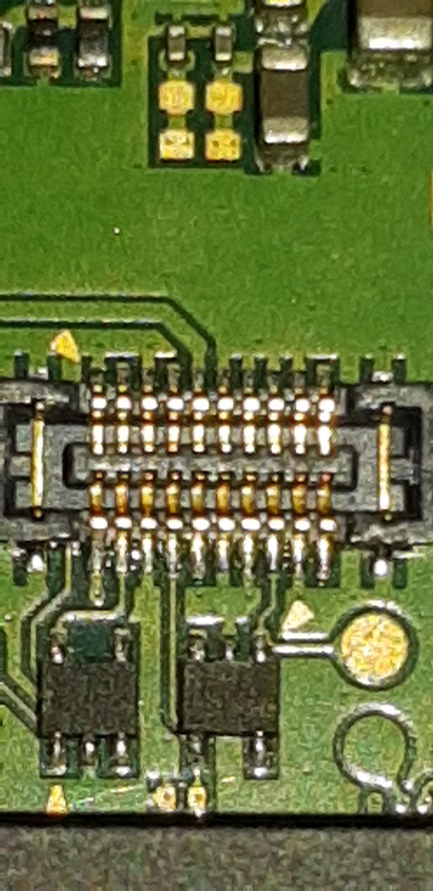

Here some pictures of the connection:
The connection on the board
The sd card reader connection.
If reconnecting the SD card adapter to the board doesn't work, you can try to get a replacement one on ebay.
Yeah I ordered one today. I hope it will work.

Your connection looks fine, so probably just the adapter since you never done any soldering, the contact point doesn't look burned.
Did you check that the cable of the adapter is connected to the board when attempting to connect it?
Reactions: gusch
Yes of course.
Your SD reader looks fried.
