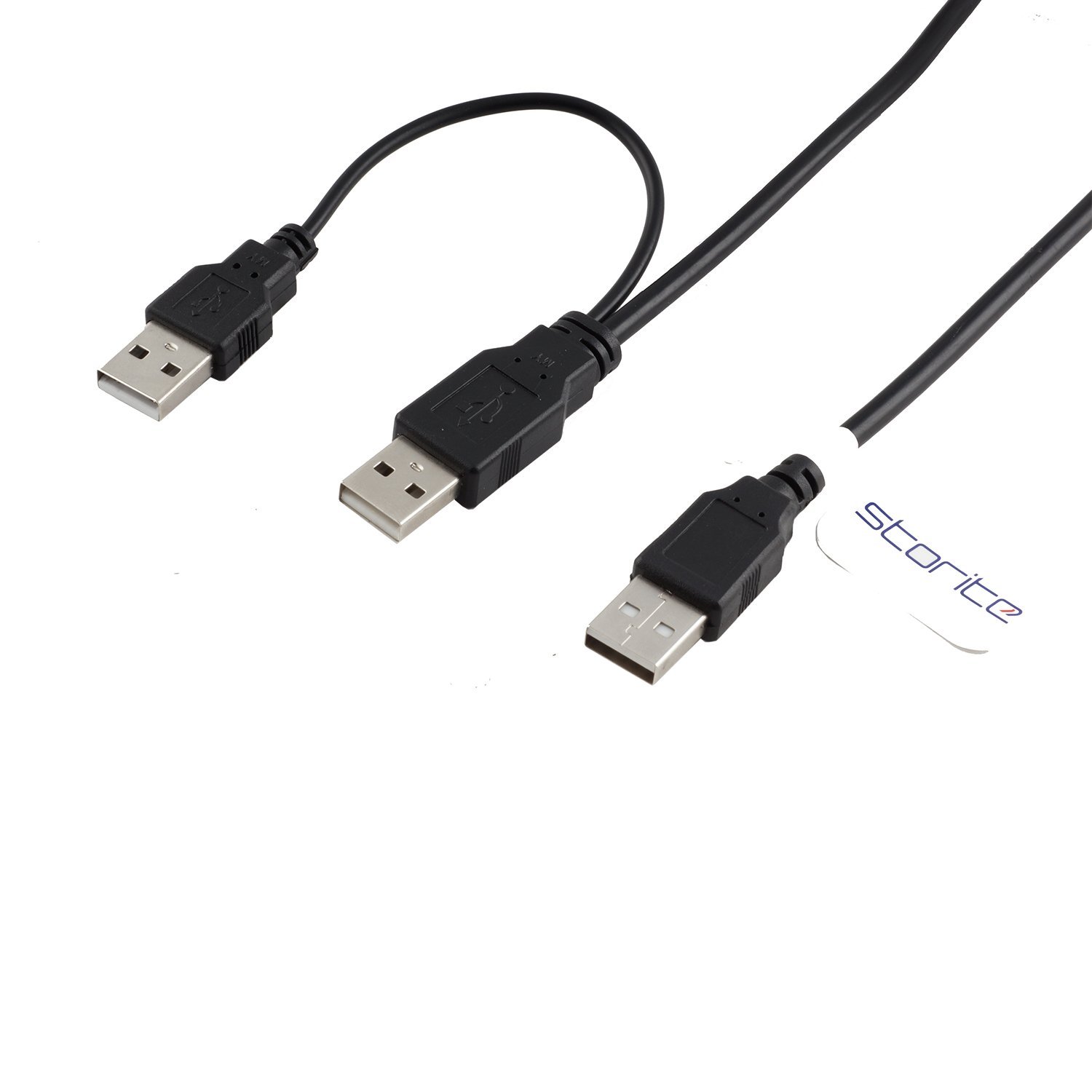

Y-cable powered HDDs are required for the Wii to provide enough power. Or as bbking mentioned, use an externally powered HDD. 2.5 HDDs should work fine with the Wii when properly powered
apparently my usb port 0 isn't giving power so can i still use a Y-cable?
Never come across a drive the Wii is not able to power. That's a Wii U issue.
What makes you think that? Can't hear it spin up when the Wii is powered on?
You can use the other port. You will have to switch to d2x v10 beta53-alt to do that but it should work just the same (might have to change the active port in the USB loader settings)
beta53-alt has somewhat worse compatibility with drives and some potential issues with emuNAND but works fine for most people.

Hi,I said the usb port 0 isn't working because when i plug the hdd there the light that goes on when the drive is powered doesn't turn on and in the homebrew channel the switch to usb button doesn't do anything and none of the emulators worked
you should use a drive with it's own power (plugs into the wall for power).
u mean like an atx power supply?
u mean like an atx power supply?[/QUOTE]
No, I mean an external hard drive that has it's own power source (gets power from its own ac adapter) or possibly one with a Y-cable that gets power from 2 usb ports.

You can overcome that part, yes, a Y-USB cable is the solution. You can even build one yourself, I made mine and works perfectly.
does yours look like this (i mean the ports)
Yes, the three connectors are USB-A Male type.
As you can see on the second image (sorry for the bad quality), on the left side we see the left black USB-A connector that goes to the HDD enclosure; on the right side, the white USB-A connector goes to the PORT0 on the Wii (the lower one while sitting flat) and it has four lines (GND/D+/D-/5VDC), like this:
While the blue connector goes to PORT1 on the Wii (the top one while sitting flat) and it only has the GND/VCC lines, both connected to the black one to the corresponding pins.
