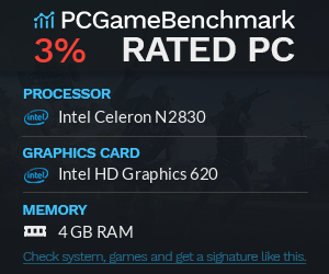

I have 16 GB of Ram Nvidia GEForce GTX 1650, but it's only a i5-9300. I am able to play Cyberpunk 2077 and most games until games that are just coming out such as the DLC to Cyberpunk 2077 Phantom Liberty, because it requires an i7 cpu. So my computer is strong enough to play it but I'm locked out from playing it.
i mean i can play those without my pc crashing
Wait...you can play games < 1GB without crashing. Is that RAM?

Look OP, in layman's terms your pc is old as hell. It's not really fit to play anything modern with that cpu and onboard intel gpu. There's nothing you can do about it apart from getting a newer, better pc/laptop.

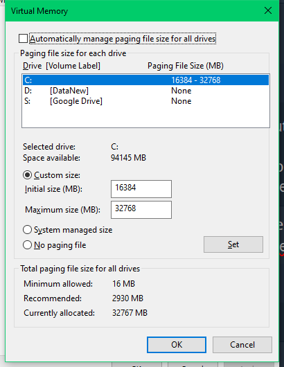

what is a page file?
It uses your drive as additional virtual memory.
Accessed by right clicking This PC -> Properties -> Advanced system settings -> Advanced tab -> Click on the top Settings button -> Advanced tab -> Change
By default it's set to automatically manage, and in most cases doesn't need to be changed manually. But you can disable automatically manage in order to manually set it to a higher number, try 8192 or 16384 and enter the same value in both boxes (click Set after changing, or the changes won't be applied)
