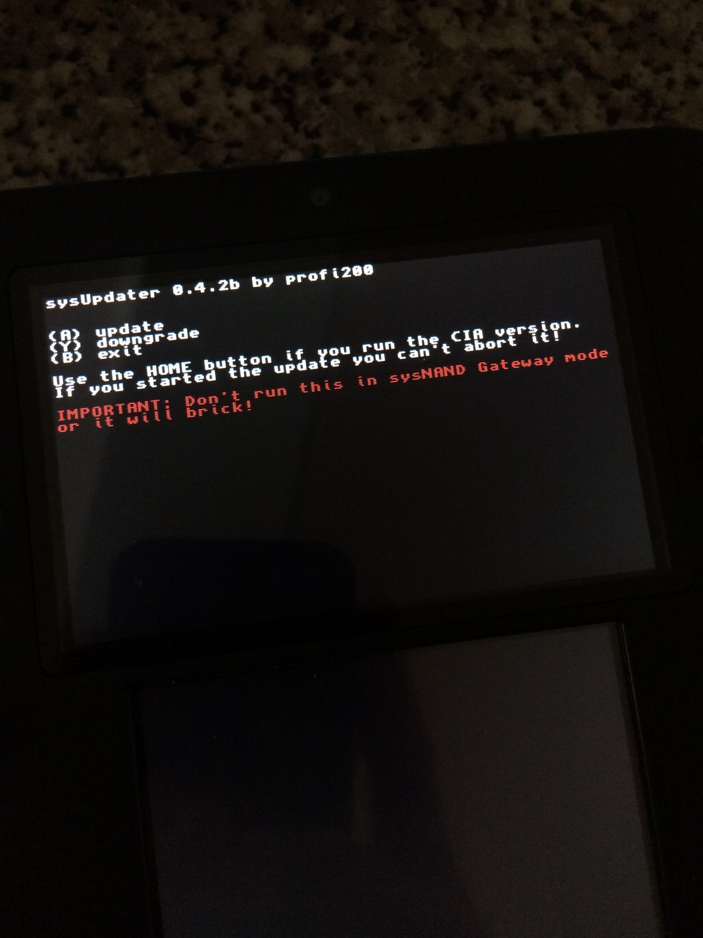

Ok I've tried downgrading but it's not working I've got homebrew launcher installed and when I go to the sysupdate at the bottom and press y to downgrade it said it was successful but when it reboots after installation it shows in settings it's still on 10.3.0 had to upgrade from 10.1.0 as the browser wasn't working for me
Below attached is the screen i seen on the sysupdate then i hit downgrade it only installed one cia and everytime I go back into it just shows me this again
Did you drop the updates/ folder into the SD card root properly?
There should be a bunch of .cia files numbered in the hundreds in there.
Moreover, do you have the right downgrade package?
Just checked on the memcard and the downloaded folder of updates and most CIA's on the memcard have gone so moving it all back over will let u know
Just checked after moving the updates folder over again and I'm still getting the same screen as I posted do I go ahead and try the downgrade again or will it not work?
Edit: no worries I managed to just go ahead and try to downgrade again and it work so I'm now on 9.2.0 woohoo
