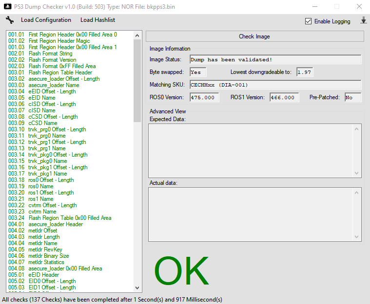

Use a hardware NOR dumper and then run PS3 Dump Checker on it. The latest firmware will show up as ROS0 and the previous firmware (updated from) will be ROS1.
