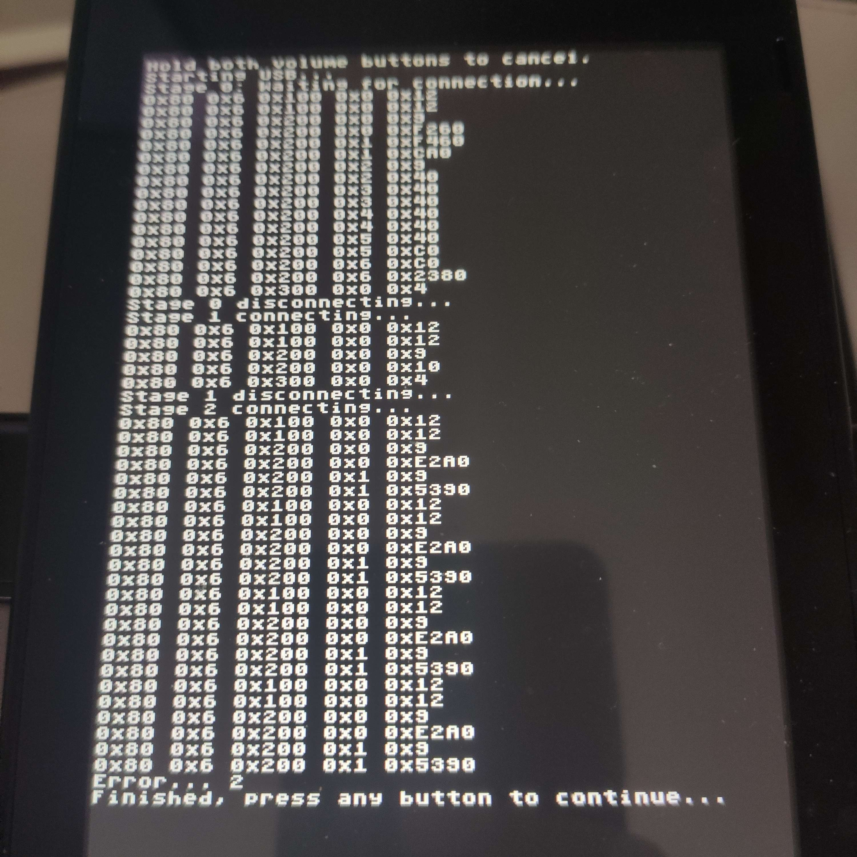

I tried to boot into recover mode a few times.
This was the best I could get. If I can get it to work however, what should I do then ?

Dump the system crash logs, so we can see the details. 5.5.1 should be exploitable. If you neither get the Browser exploit nor DNSpresso to work UDPIH should still work

The Browser exploit or DNSpresso or UDPIH would be easier. Which ones did you try?
