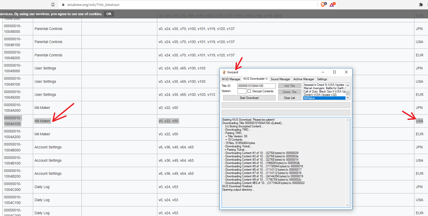

I still need to understand a detail about how the install_wup that comes with BluUbomb works.
Based on my WiiU's region, I used UWizard to download Title ID 000500101004A100 for the corresponding Mii Maker.

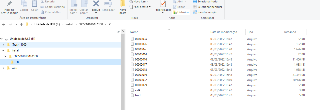

Now I put the folder 000500101004A100 inside SD:\install
You should put the files directly into the "install" folder. The title.tmd file should be directly in the "install" folder without any subfolders.
Your files seem to be missing the title.tik though.
Should I use the new version of BluUbomb or does the old one work normally?
I recommend using the latest version. It fixes a few stability issues.

A folder containing installable files is a WUP.
Putting a folder into the install folder is creating a subfolder.
So to make this clear, this is how the layout on the SD should look like:
/install/
/install/title.tmd
/install/title.tik
/install/00000000.app
/install/00000001.app
[and so on]
Reactions: Rick Astley

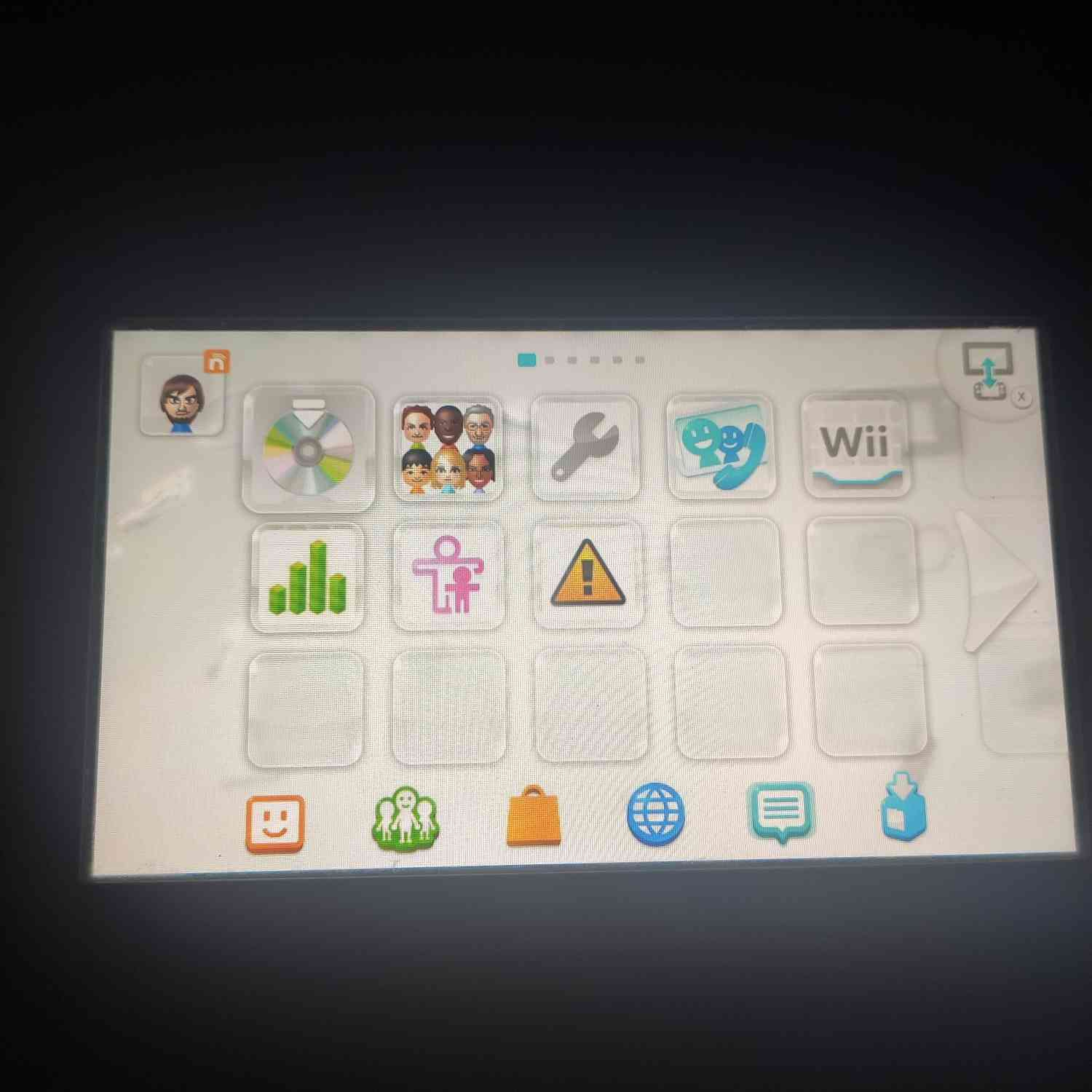

And after running everything...
HURRAY. IT WORKED \o/
It was really only the Mii Maker Channel. I got the console to update to 5.5.5 (it was a 5.5.2 how curious haha) and I've now something 100% clean.
Last question : Based on the logs and stuff, no issue to go for CFW right ? Just need a SD Card now.
It took 1 year, but that Wii U is finally saved and alive \o/
Thanks a LOT to @GaryOderNichts for the tools and the help ;___; <3
Edit : Well nope, got an error while updating to 5.5.5 : 162-4065 at 99% when applying it. After rebooting the gamepad doesn't detect the Wii U and the TV gives me nothing yay. So can't do anything like botting the recovery menu. Is there any last hope or this time i'm good to say that i've been dumb enough to kill it ?

Welp there has to be a reason why the Mii Maker got corrupted in the first place. Most likely is a hardware failure of the eMMC chip in the console.
Since I couldn't find any other logs indicating a bad chip I was hoping simply reinstalling the Mii Maker would be fine for now.
It's possible that updating the system ended up causing a lot more load on the chip, which caused it to fail.
You might be able to still get into the recovery_menu though, even if there's no video output.
Try it a few times and see if you get the purple LED.
