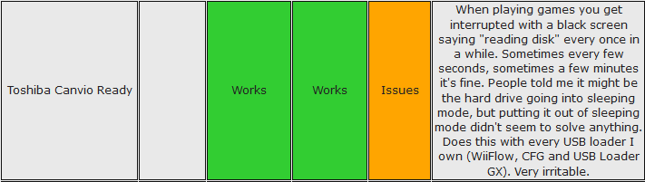

The compatibility list on gba temp itself informs me my drive is compatible. Is there something Im doing wrong?
