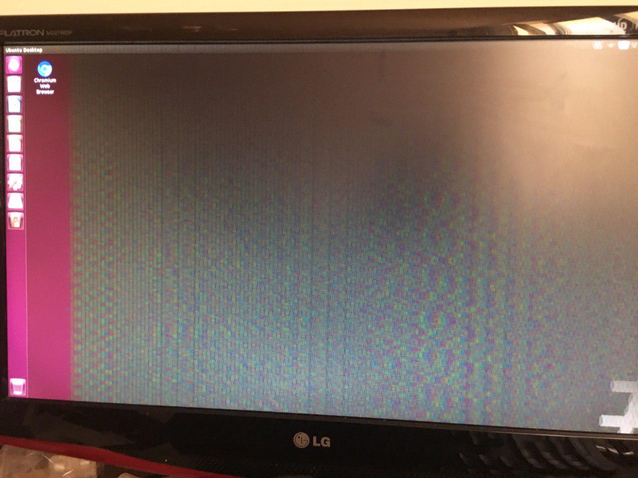

I tried searching the thread but I didn't find anything similar to my issue.
After docking I'm observing the following bug: the discolored image is moving, it is distorted and glitchy, looks like a broken videocard. Only happens in docked mode, handheld mode is fine. Tried reinstalling and updating, downgrading—nothing helped. Any suggestions?
Also, is it possible to have both Lakka and Ubuntu on the same SD card? FAT32 partition from Ubuntu image is too small for Lakka, and I was not able to resize it.
Any help would be much appreciated.

You can expand the Fat32 partition using another Linux computer (or a PC with a Linux live USB)

Yeah, I have noticed this bug too. Quick fix, change your resolution a few times till the output looks correct. Doesnt happen often but thats what i do when i see it.
And yes you can put LAKKA, L4T Ubuntu, CFW all on one SDCard. From Windows you can use any partition manager software pretty much to extend the FAT32 but if you need to move EXT4 to make unallocated space for the re-size I would suggest using gParted live or any Linux machine. Windows you can something like eassos partition manager but use with caution, i would never trust anything from Windows to work great 100% the time with other filesystems. If you dont have a linux machine handy, use the live i686-pae or amd64 version. Backing up your SDCard is always a good idea.
Good Luck!
