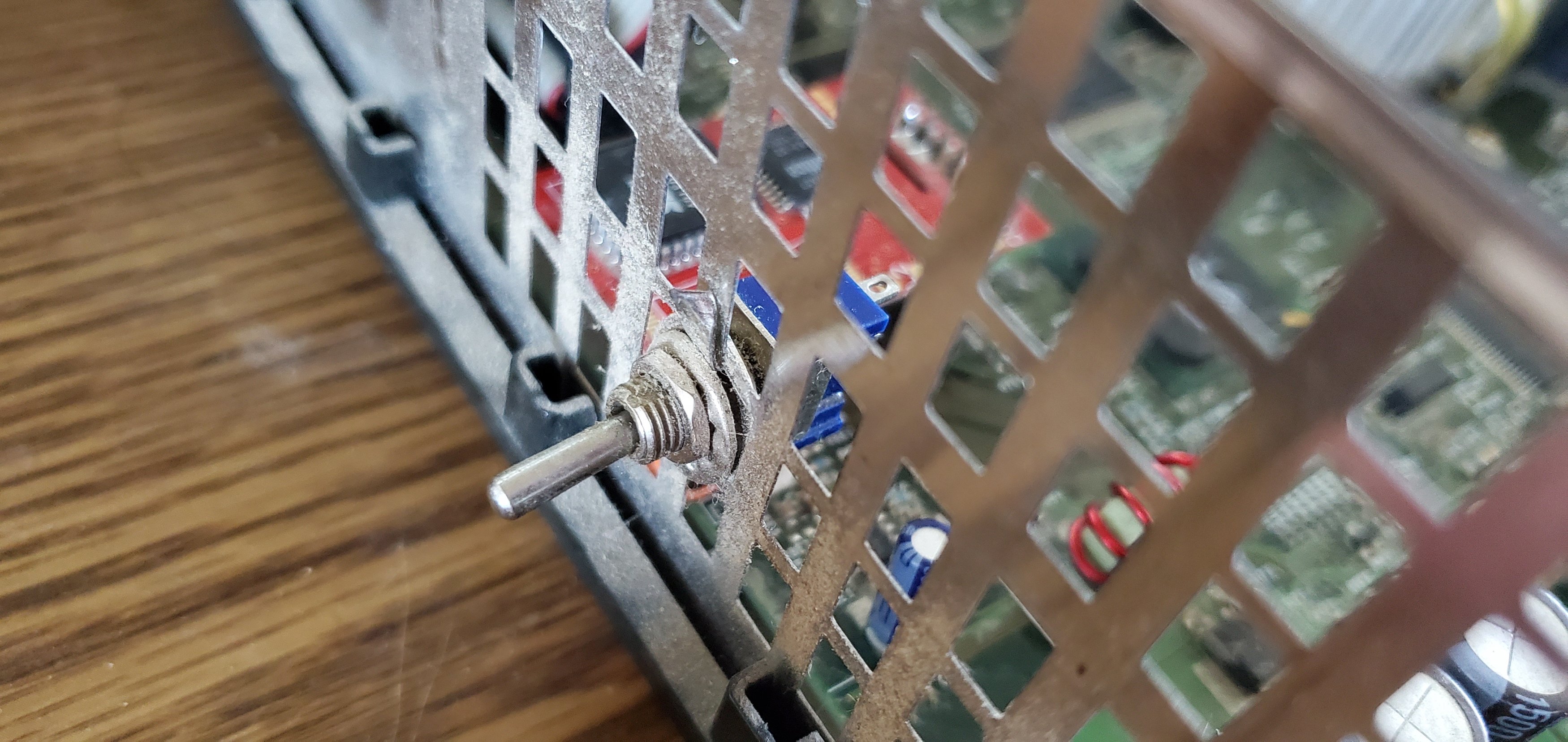

So it's looking like I have a modchip in this xbox, I believe it's an Aladdin Advanced, so I'm not sure what to do next. I've done a little research and apparently I can update the bios on it, but that doesn't tell me if I can update the unleash x dashboard that's currently on there.
**Edit** there is a switch soldered to it with the orange wires, not sure which way is on and which way is off, I assume down is on as it's a three pronged switch and wires are attached to the bottom two and nothing is soldered to the top one. Correct or incorrect?

You can switch out the harddrive, the chip will allow booting from CD.
Use Slayers CD to prepare it and install UnleashX.
No need to update anything.
Afaik, booting via the Eject shuts the chip off.

It's not soldered to the eject button, it's soldered to this switch on the side of the Xbox which is my confusion haha.

Sounds like a standard SPDT switch (single pole, dual throw), that means one input switched between two outputs. So yes, whatever is connected to the two bottom pins will be bridged when the switch is in the bottom position. In the top position the middle and top pin will be bridged but since there's nothing connected to the top pin it effectively means the switch is off.
I guess having an on/off toggle switch for the modchip could be useful.

I'd say flick the switch and boot it.
Chip BIOS is 9/10 times always different from the stock one.
Edit: that way you can figure out the state of it.
Once it's active, proceed with upgrading the HDD
