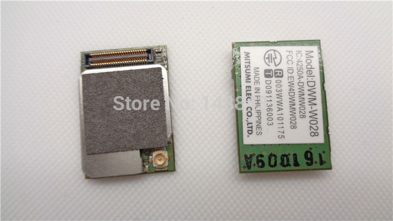

You may have actually knocked something loose. B9S actually boots so early, that it beats most of the hardware's boot cycles. I had something like this happen over the Summer.
https://gbatemp.net/entry/3ds-repairs.11371/
TL: DR version, my wireless card was loose, so I just had to gently push it back into place. But my CFW and payloads could be accessed because they booted before the wireless card.

The 3DS doesn't have that many parts that aren't soldered down. So it could be any of those that could have gotten knocked loose.
Hell, chances are it's the wireless card because that's the easiest part to knock out

Really it's as simple as opening the system and gently pressing down the suspected part. In this case, I would suggest looking for the wireless card because it's the most common part to knock loose and also easy to spot. Seriously it just looks like a generic wireless card
Then loosely reassemble the 3DS and test it.
If it works, yay!
If not, then keep gently resetting all the loose part until it works.
Nintendo proper are super codependent on every part of the hardware being there. So any loose part will cause issues.
