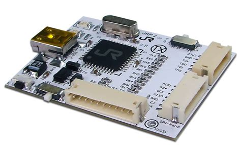

Hi Guys,
I'm kinda tearing what little hair I have left out over this - please tell me there's a silly step I've missed somewhere.
I can't get a green light from my JR Programmer V2, regardless of the configuration of the switches. For redundancy, I'll add a picture of the model I'm using.
I'm using Windows 10 - in the device manager, it shows up as a "USB Input Device" under the Human Interface Device tab - not Pruftechnik as a USB device like multiple people with the same programmer report.
I've restarted with signed drivers turned off, installed the drivers successfully, and I still only get a red LED, regardless of configuration.
The JRunner program, V3.0.0, does not show the logo as expected, but will recognize it as a bootloader with the switches in the appropriate configuration.
I've tried this on two separate Win10 installations now with the same results.
Have I done anything wrong, or should I throw in the towel and buy a NAND-X ?

Running Jrunner v0.4?
I think your programmer must be faulty then, hate to break it to you.
Tbf I never had a JR programmer, me NAND-X continues to serve me well ;p

On win10 Disable driver signature enforcement,
Also sometimes you gotta plug it in and unplug for a few seconds then plug it in slowly
When you plug it it it should flash red then immediately hold solid green, then it's ready
Mine sometimes will have this issue too, it goes red as soon as it's plugged in

Thanks for responding. Unfortunately I have tried all of this already!
I think I will probably sell it as "not working" to someone who might be able to get it working on their PC, or fix whatever is wrong on it. The NAND-X has been serving me well, and has just helped me RGH another console :)
