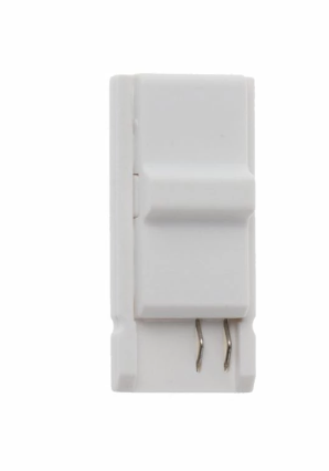

Well you test the different version of jig, I couldn't get cheap 3d printed one to work, only the white one I shown actually worked for me when I tested an unpatched switch. If you got through few jigs and it still doesn't work might be that rail
