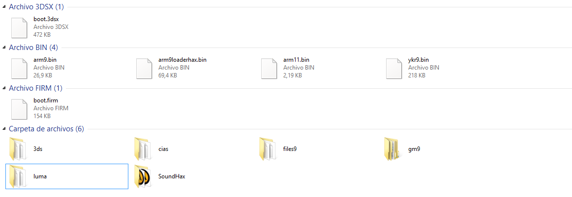

Basically, it won't start without a SD card (Blue light blinks). But when it starts, the touchpad and the buttons stop working, so I can't do anything.
I know the buttons are completely fine because I can boot into godmode9, luma, etc. and they work just fine. So I've been playing around with the files inside the SD card trying to fix this but nothing.
Here's a couple photos of what the N3Ds looks like when it starts (sorry about the bad quality lol), and what my SD card's files look like.
This behavior can mean “permanent touch input detected”.

Thanks a lot. I managed to get the last version of gm9 working. Although for some reason the menu's options couldn't stay still and I couldn't select the options properly without holding the right directional key (It was like I were permanently pressing the up directional key).
I managed to work with that anyway and finally opened the touchscreen calibration, but when it told me to touch the first red cross in the upper-left side of the screen, It didn't do nothing. So I'm assuming it is a hardware problem with the touchscreen.
I will try to find some tiny screwdrivers and see if I can fix it. Will keep updating.
