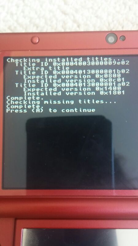

How can you backup the Streetpass plaza? Or its not possible...
I did not format my system before downgrading (though i did format the SD) I still have everything!
downgrade_checker returns this. Should I be concerned?
That looks like the wrong downgrade_checker. You should be using the one that displays the titles of the applications, makes it easier to tell.
