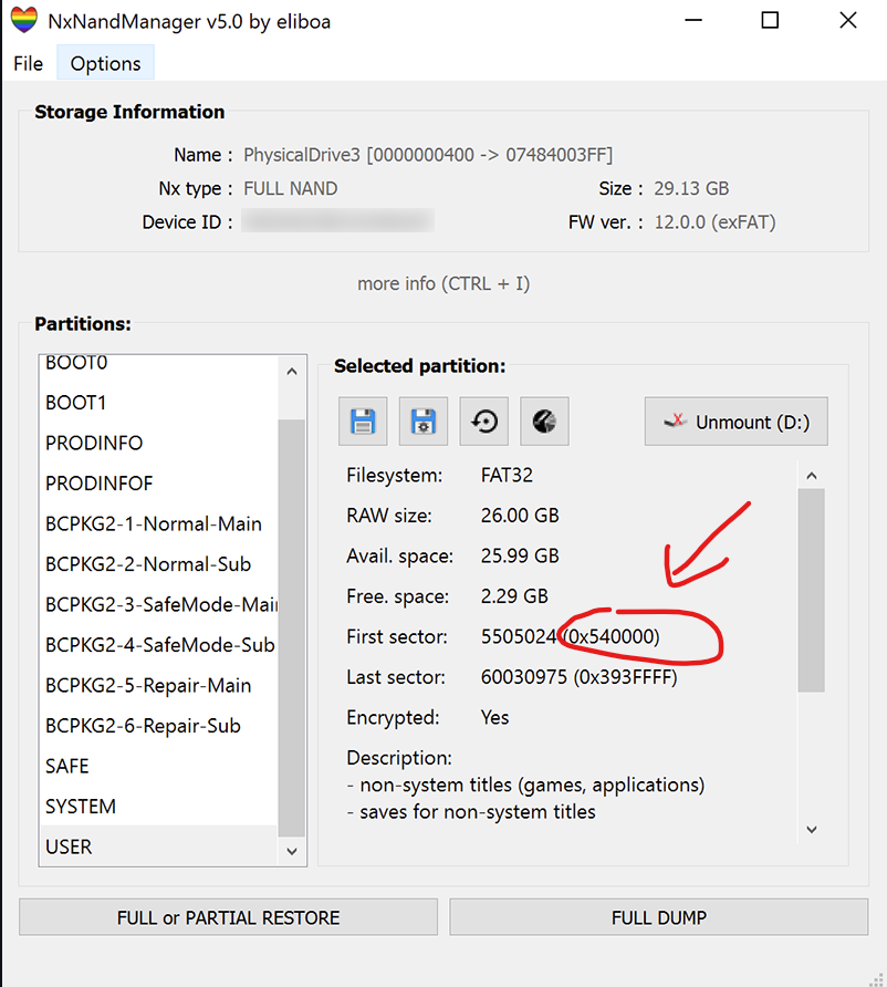

Follow this guide:
https://rentry.org/EmuNANDNewSDcard#nxnandmanager
When you are finished, open the emunand on the new SD card in NxNandManager and note down the first sector:
Open emummc.ini in /RAW1/ on your new SD card and edit in the new sector.

There has never been a "/RAW1" nor any "/RAW?" directories/folders for our SD card. Are you referring to the internals of the emummc? Not all have a flat file system (yet), some of us still have the RAW partition for the EmuMMC. Also when you click on the NXManager, you have to highlight the "USER" partition from the left side of the App in order to get to the first sector of the 'USER' partition, not the start of the boot partition.

You are right, it's not in the root of SD card, it's in /emummc/ folder.
