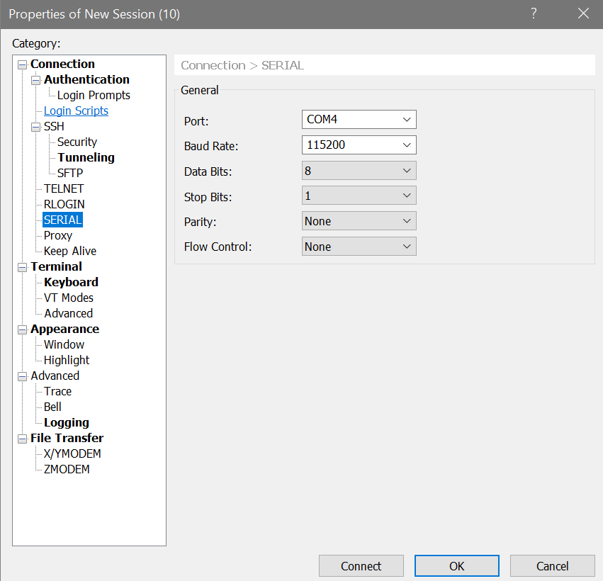

I use xshell as I also need to ssh into some linux vps, just change connection type to serial and change baud rate to 115200 in serial settings:
also the new line symbol instinct sends is different, default cr will cause character to scroll all over the place, using auto fixes the issue:
